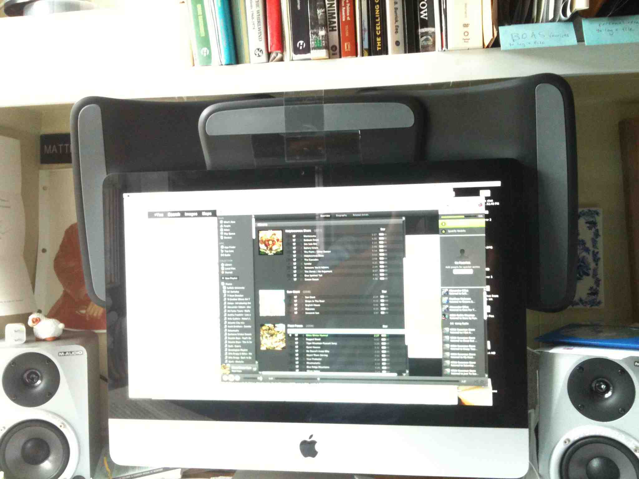

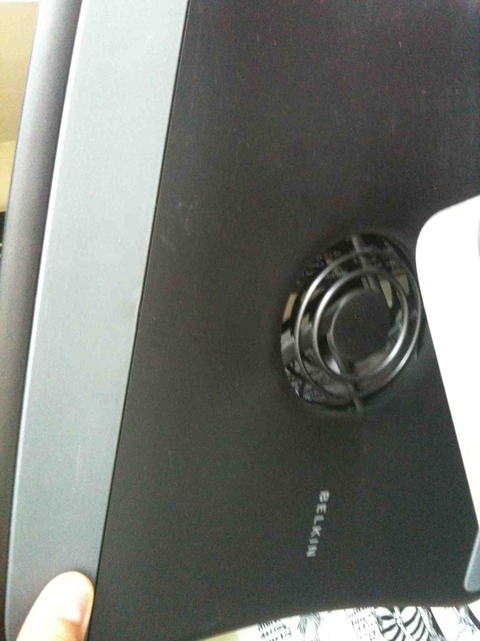

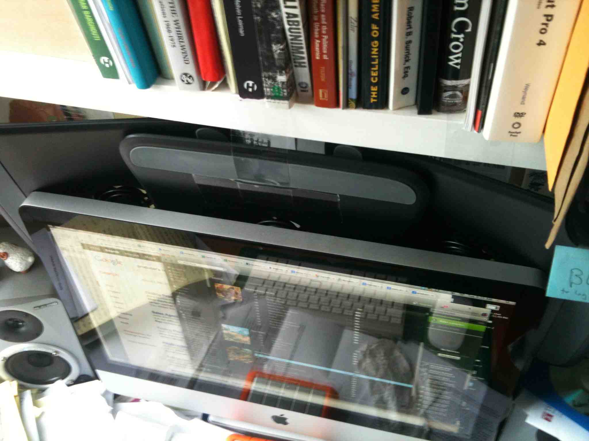

Hi all,
I had this same problem with my iMac getting unbelievably hot to touch on the back top of the computer (front as well, but really blazing on the back). After some research and thought, coming from the brain of a computer-phobic non-techie, I decided to see if I could solve the problem by hooking up some additional fans to cool the computer at the back. I don't mean taking apart the computer of course, just adding some additional air flow behind it.
I totally solved the problem for about $65-70, no messing with computer settings, no taking apart the computer, no AC unit installed behind my computer (although I thought about this).
I run lots of programs at once, lots of windows, lots of music, and lots of videos, so it's going to get hot. I got some of these belkin laptop coolers:http://www.bestbuy.com/site/Belkin+-+CoolSpot+Laptop+Cooling+Pad+-+Black/4635326 .p?id=1218501938631&skuId=4635326&st=Belkin%20Cooling%20pad&cp=1&lp=2
My iMac sits directly under a shelf, so I was able to hang 3 of these so the fans hit directly on the top back of the screen (see pics below). I looked at all the brands at BestBuy and this seemed like the cheapest best one, and wanting a fast solution to this I just bought one to try it. When I plugged it in to the USB and fel the pathetic little fan I thought to myself, "you're kidding me, this is a piece of crap." But I tried it anyway, and it really cooled it off. No more serious heat. It was still how on the left and right sides since the fan only rested on the computer in the middle. So I went back and got two more, and got a USB splitter (you can usually find these at Marshalls for like $5) so three fans only take one USB port on the computer.
I am so happy with these Belkin cooling fans, and this really saved my computer, that I am going to post this everywhere I can find. This is a really nasty problem to have to deal with, and this is a good cheap solution for even no-techie types. It doesn't look too bad either, but I could see some people who are obssessed with how their mac looks not liking these cheap-o laptop-coolers crowding its style. Oh well. Trust me, it works!
