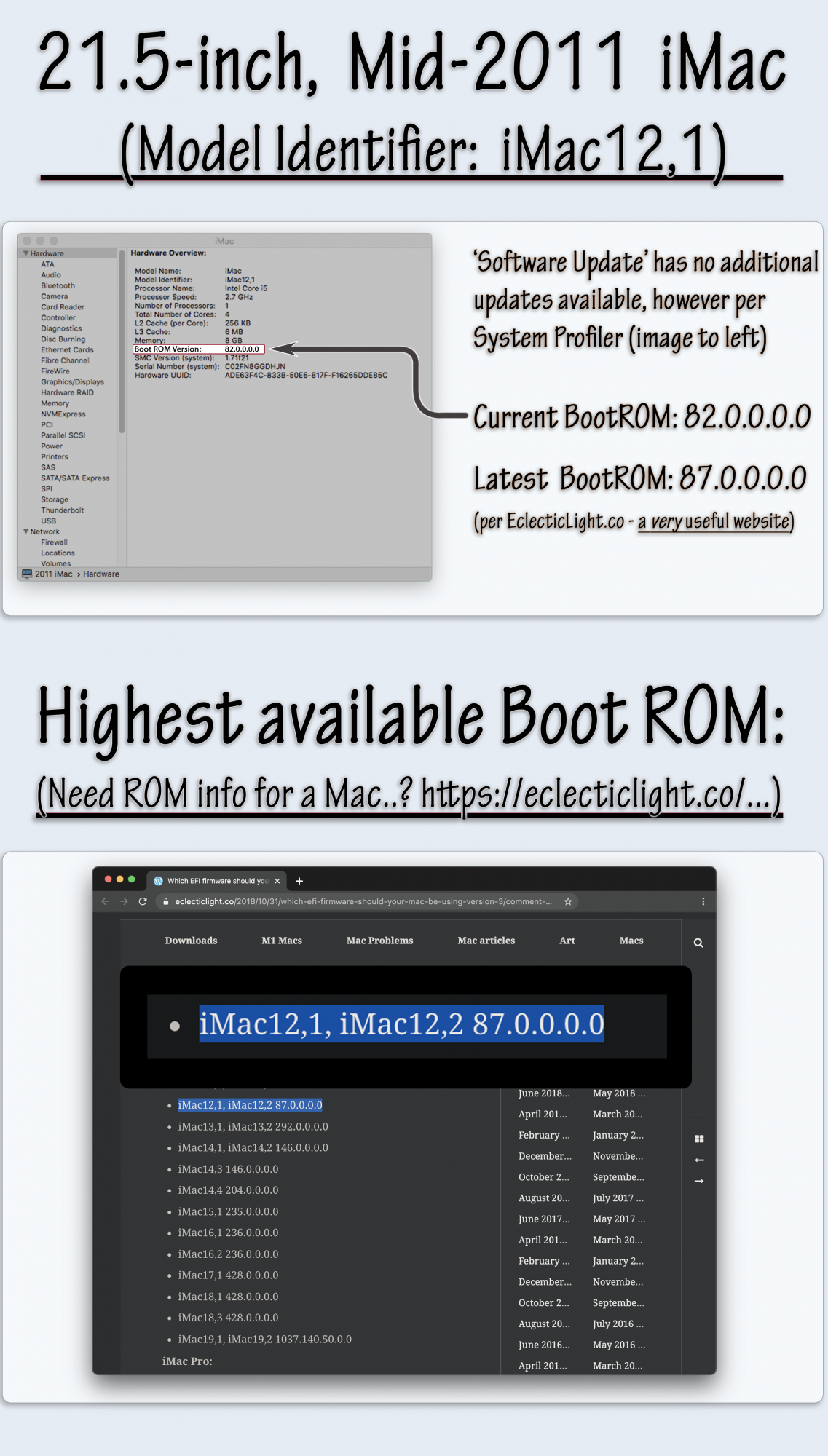

Working Mid-2011 21in iMac
• Customers 1TB piece of ___ (would've been under the QC program until 2014 I think) died.
• Attached SATA SSD via TB-to-SATA (Seagate FreeAgent)
• SATA SSD (Bootable: 10.13.4).
• Ran updates to upgrade the OS (hoping it upgraded the ROM).
• SSD / OS found 'updates' and upgraded to 10.13.6 (but didn't do an EFI upgrade)
• The NVMe drive can boot any of the 10+ machines I'm working on or own.

Oh! Re: 'possible other means' ...
I just realized, I can probably download the version which has the newest Boot ROM from GhostlyHaks.com (they have all model EFIs available for download, which I'd then need to customize on a windows POS system) to make the SN be the original one ... but it's almost certain that the repository has the most updated version or ... someone probably has one. ... (if no other method is more convenient).

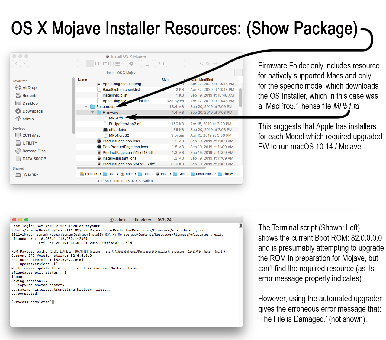

SOLVED: But in a bad way ...
While snooping around the resources of the OS X Mojave Installer (which said: This copy of the Install 10.14 application is damaged, and can‘t be used to install macOS. when I tried to install it on the iMac, but works on other systems)...
I checked out the folder labeled Firmware to see which resources were present.
(After being totally stumped wondering what in the world MP51.fd could mean..?? lol ...)
I now assume that, if (and only if) you're using a 'legacy system' which needs the addition of NVMe, it's provided as a preface to the upgrade to OS X Mojave. Obviously I downloaded this on a 5,1 I wanted able to boot from NVMe drives.
Obviously (and unfortunately), I’m guessing Apple doesn’t provide [all potentially required EFI’s] in each OS X Mojave installer for their customers to have a swiss army knife ... commensurate with what you and I would like. But instead,
provide only what you need (if you even need it), and only if you're upgrading to Mojave...at which point, they provide
the version which has the EFI for the hardware from which you're downloading.
Thus, if the window of opportunity from which,
A. You're eligible // Apple is providing access to 'new downloads' of said OS.
B. Your hardware requires the EFI upgrade
C. Your hardware is supported (per Apple's beliefs) to run Mojave...
Then and only then are you allowed to download the version which contains the EFI to upgrade. your Boot ROM.
This is why (above) I said "you don't have to upgrade to Mojave, just threaten to & it upgrades the EFI in preparation."
Now however, as they’re not even providing access to Operating Systems I’ve previously downloaded from my AppleID ... the only way to get whatever specific version of Mojave (Firmware update) I need to upgrade now (and every time for any other hardware I'd like to update) will be predicated on luck and eventually the repository I'll make to address the issue...which I'm guessing will take a WHILE.
Anyway, again, thank you for all your help earlier ... and here's the pictures which led me to this belief.
(Off to check all the OS's I have laying around from previous customers, and my 'utility' drives to see if any of them serendipitously have Firmware resources.

My assumption that Apple 'Bundled the ROM' with Mojave Upgrader for this iMac is WRONG: Mojave req. 2012+ iMacs
Still ... the 2012 and 2013 iMacs FW appear to have been bundled with Mojave.
I think the error message "This Installer is Damaged" is when it lacks the included FW for the machine installing it.
(as in, it was downloaded on a MP but being installed on a 2012 iMac13,1 ... etc)
the ISSUE ... is that Firmware updates weren't mass released ... and are only COUPLED with the upgrade to Mojave it appears -- FOR THE EXACT HARDWARE of the machine downloading it. (Hence, the MP51 file being the only firmware available on the version I attempted to use). That's IMPORTANT info -- and is why I'll never delete a Mojave installer again without looking at which devices firmware it has in order to compile a repository of different Firmware updates for different hardware.
