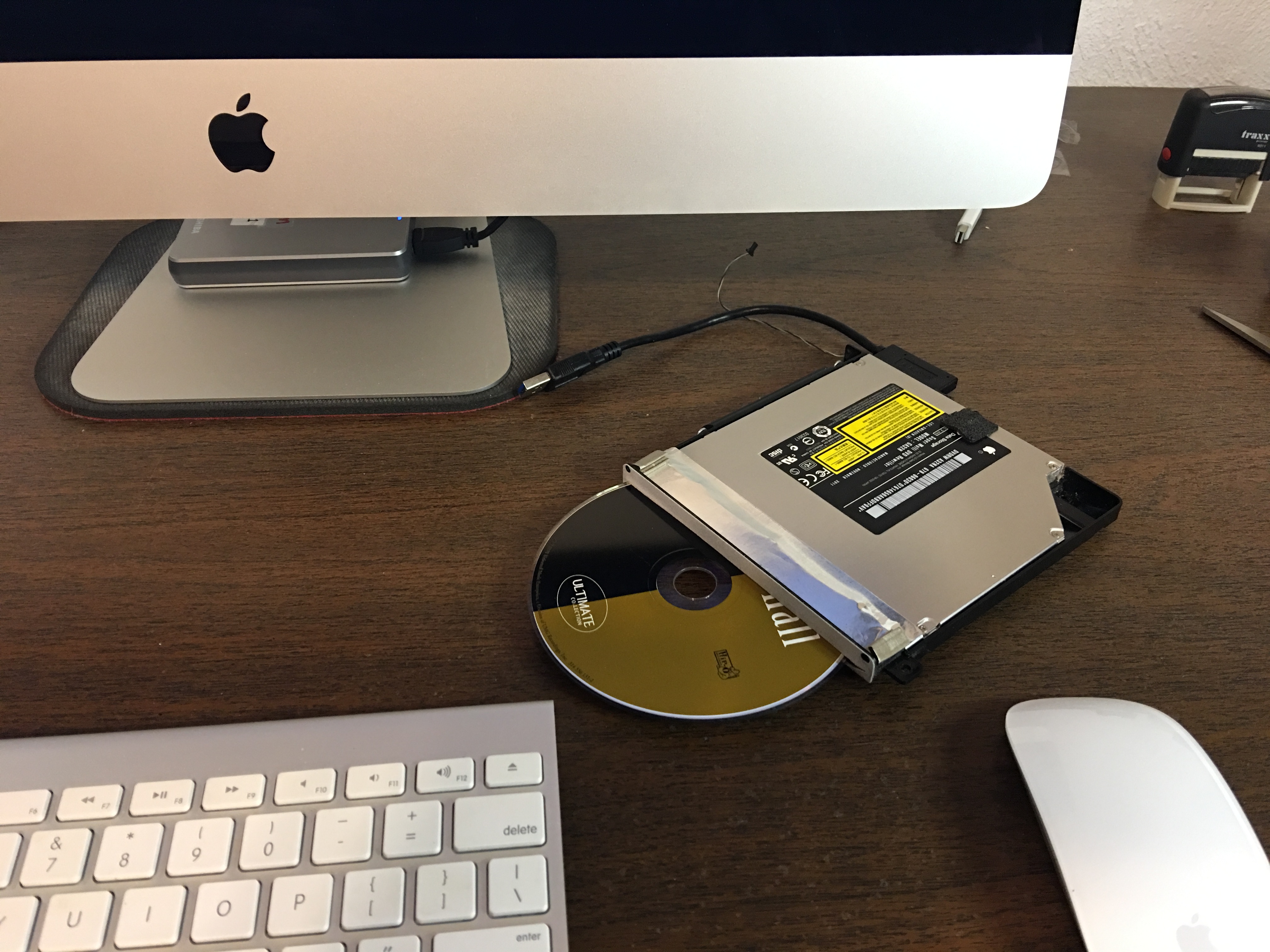

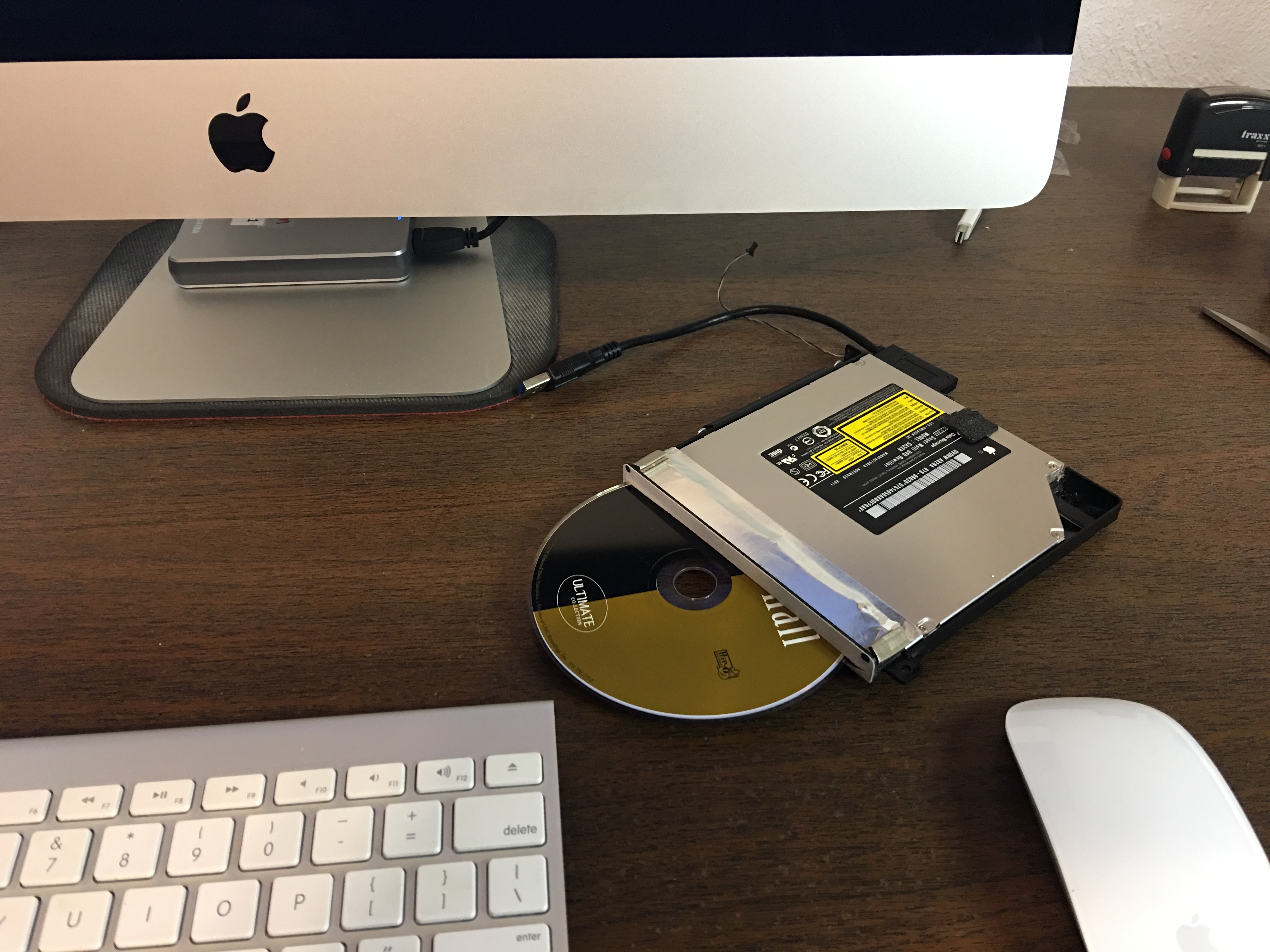

I removed a good working internal optical drive from my 2011 iMac 27". Bought a USB cable for it hoping to use it as an external with my 2014 iMac 27" which of course has no internal optdrive.

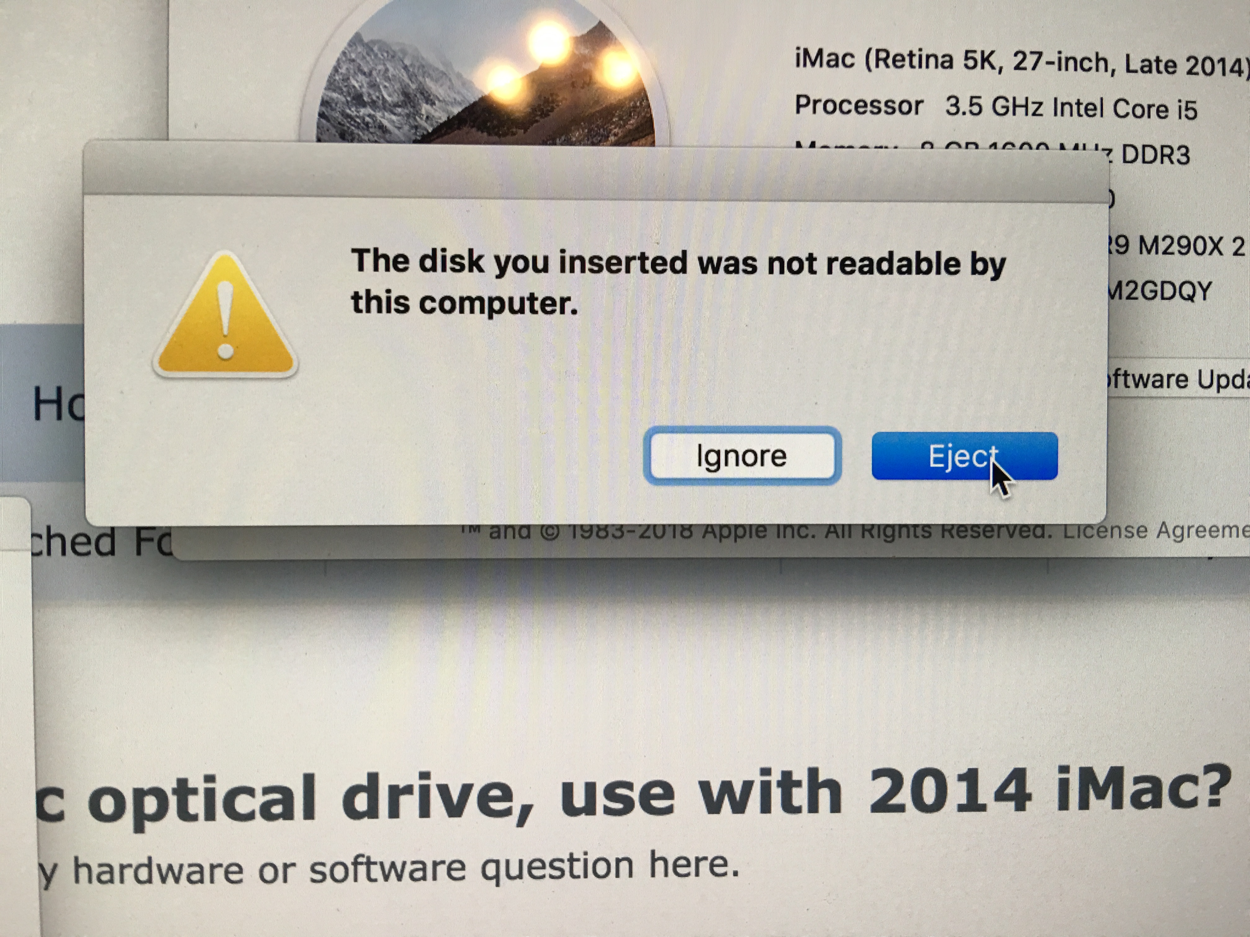

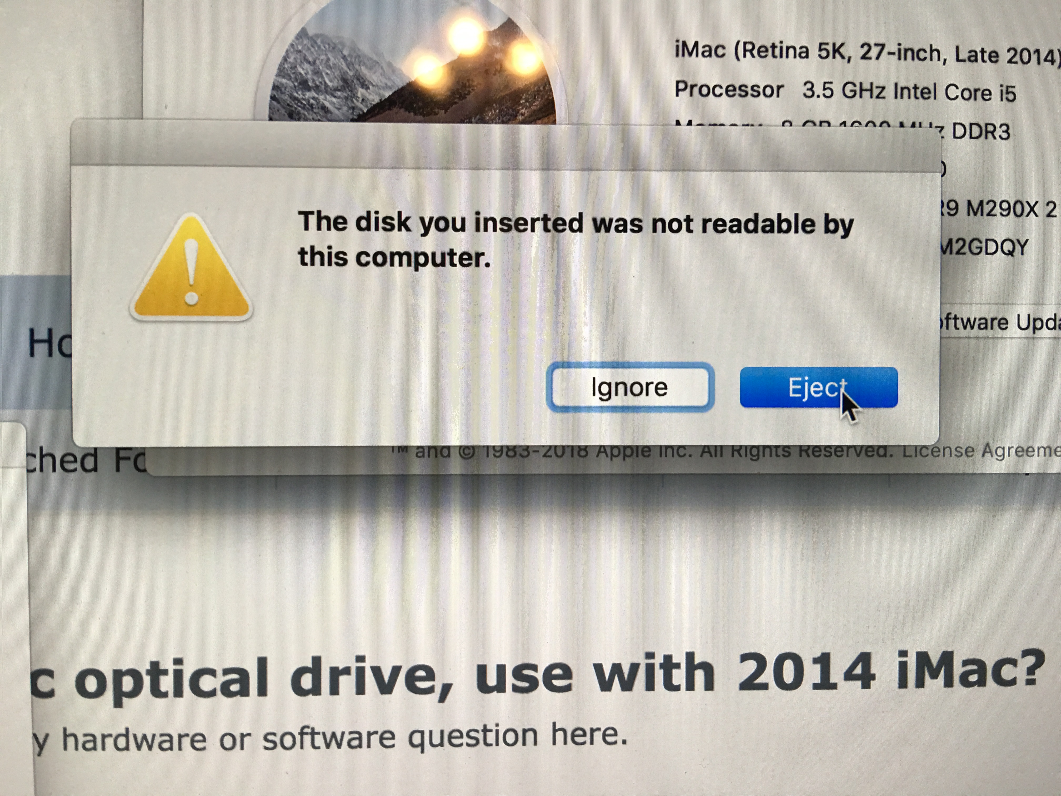

I plugged the drive into the 2014 USB. Drive has power and inserting a cd went fine. Sounds from the drive indicated normal activity, but no drive icon appeared on 2014 desktop. Without any further actions from me, got a dialog box saying this disk unreadable on this computer (I tried several store bought disks). The dialog box contained offer to eject which I clicked on and the disk ejected normally.
Is there something I can do to get this drive working properly in the 2014 imac?

Wild guess here, based on the picture, might not be getting quite enough power to the DVD drive, as you've already got an HDD plugged in (and anything else?).
Not same, but, have seen where two HDDs are plugged in, spin up, lights on, but not showing on the desktop. Once you move them to a powered hub, all is well.
So, maybe unplug that HDD and try again?
Thanks. Good thought. Leaving the other 3 USB ports empty, no change. The drive sucks in the cd, makes all the "normal" sounds then goes silent for a minute or so before I'm given the opportunity to eject. It ejects promptly. But never does the drive show on the desktop or in disk utility.

Might be a long shot, but try each USB port on the iMac. Sometimes some ports are not fully powered in my experience.
I've just tried each of the 4 ports. No change. Thanks.

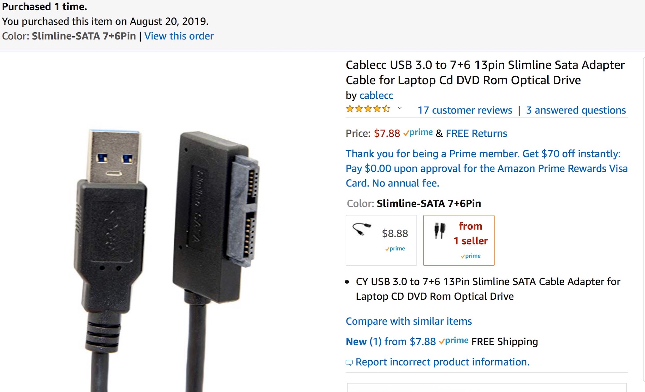

The internal optical drive on a 2009–11 iMac is connected to a SATA II bus.
If you can get the right cabling, a SATA to USB adapter should work.
OTOH, you can get a USB CD/DVD drive well under $20.

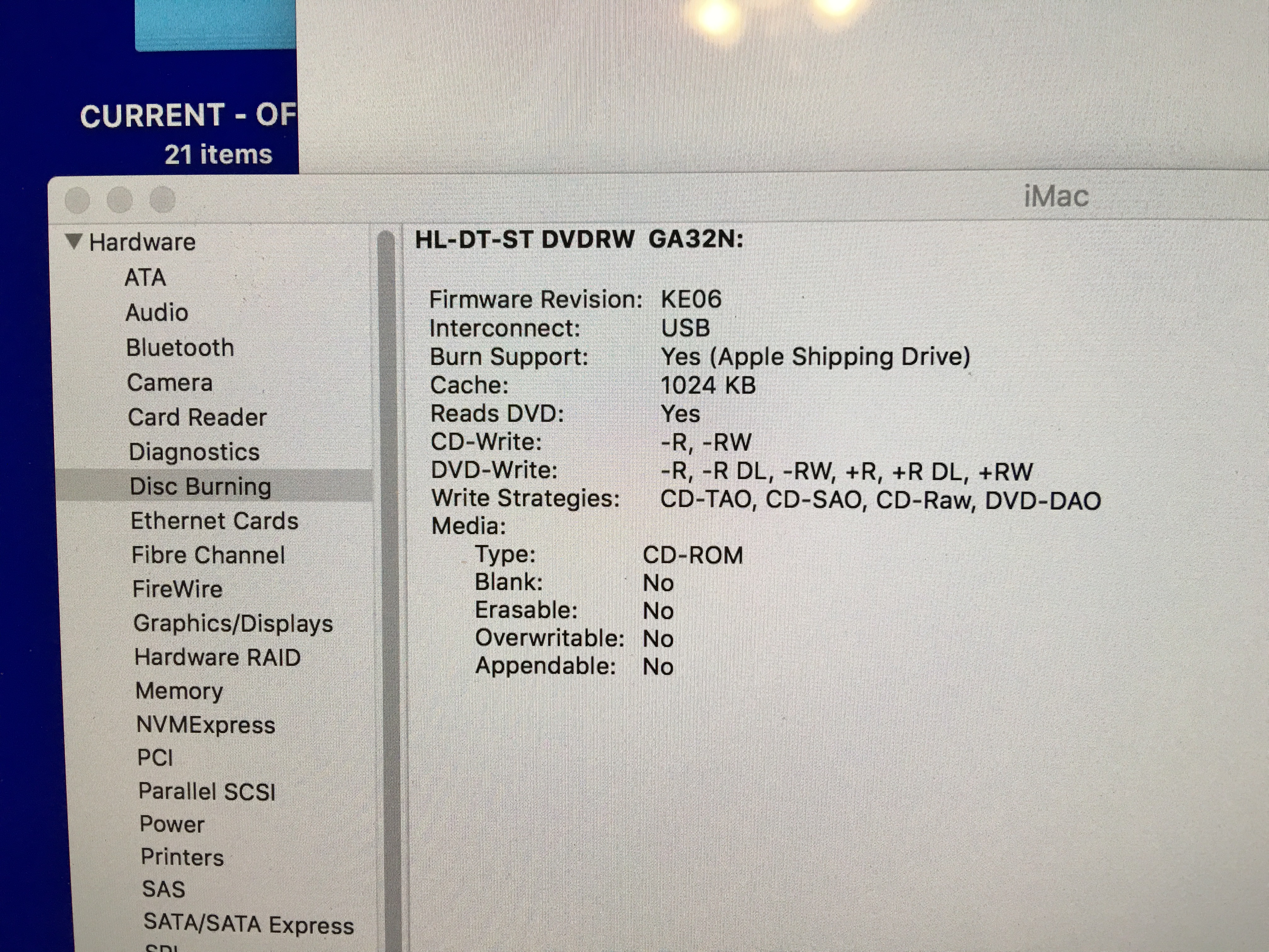

Mike, pictured is the cable I bought. Powers up great. Injects and ejects a disk, but just will not show on the desk top. I just like to make old thinks work I guess. Best buy has an LG writer on sale for $20. Will grab one tomorrow if I don't get this one going. Thank you.
