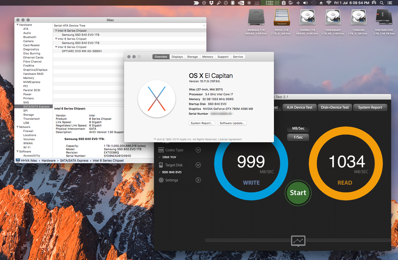

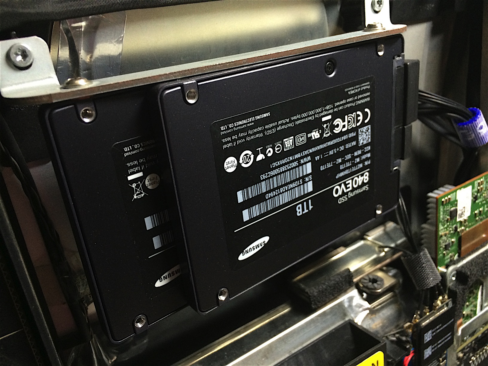

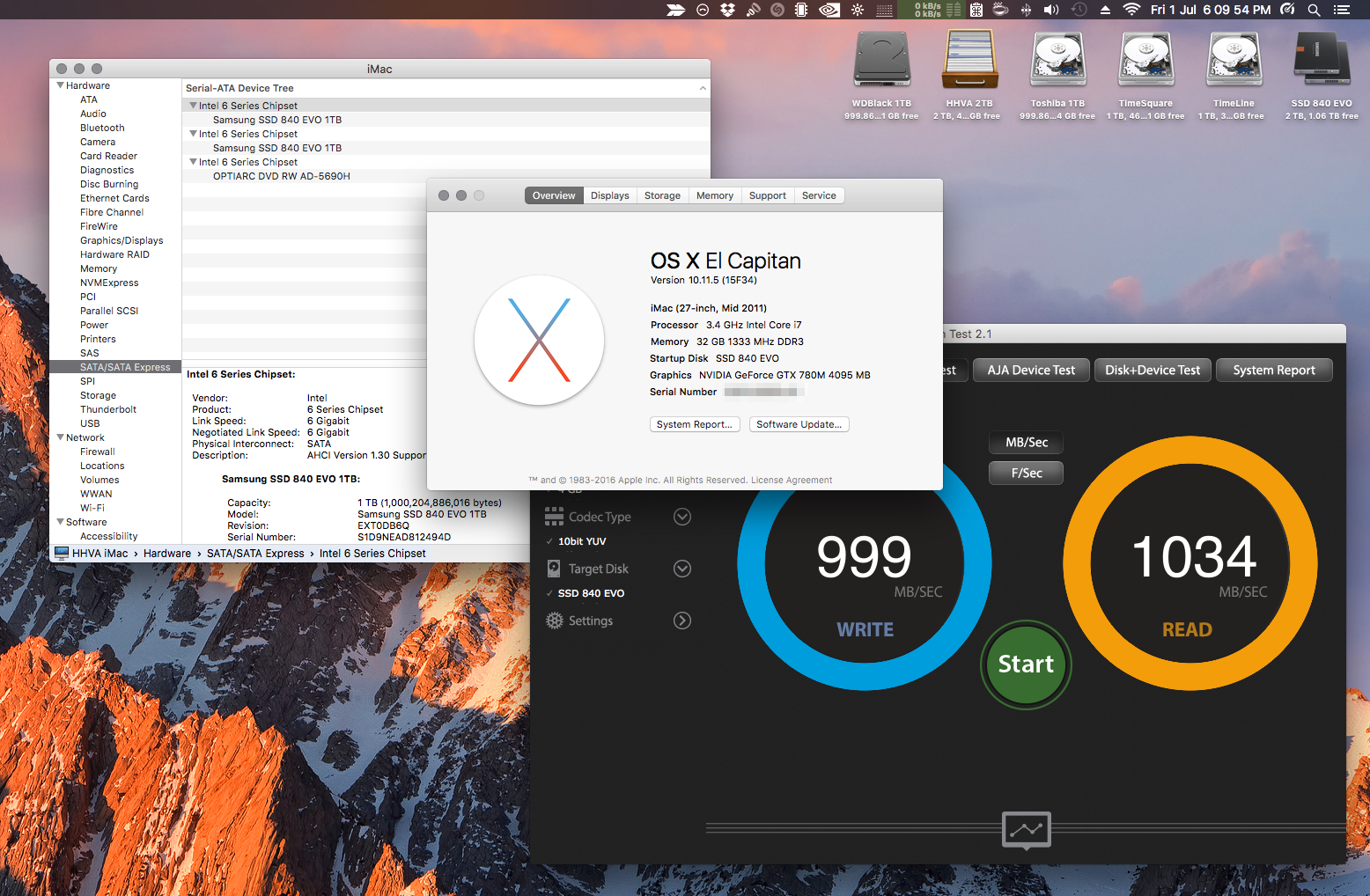

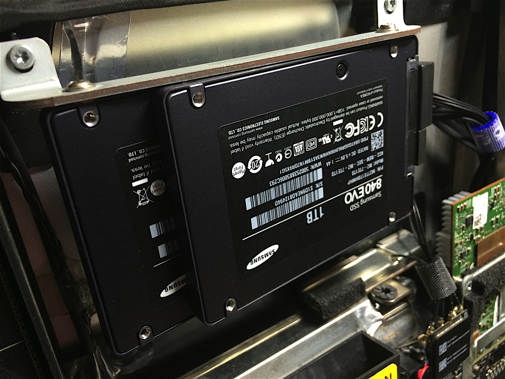

Here's my setup. 2 units of old Samsung 840 series in RAID0 setup both fastened into the main storage bay. I just use this free apps SSD Fan Control and sets it to "Smart", no need to install that In-Line Digital Thermometer from OWC kit. Awesome results!
