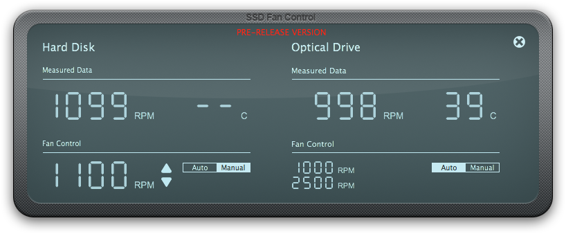

Download SSD Fan Control to slow the fan speed to make everything quiet again.

Just download SSD fan control, its free. Also use a TRIM support enabler. Im running snow leopard and used to run my SSD in the primary bay. Was a dodle.

I'd also rather use smcFanControl than some "SSD fan control". http://www.eidac.de/

So... SMCFanControl will return the HDD fan back to normal speeds?
It doesn't work on either of my iMacs to return the HDD fan to normal after installing an SSD.
I have 3 27" iMacs, 2 with SSD's the third being updated to SSD next week. The 2 have had SSDFanControl installed for quite some time. 1 of them being used 12hrs a day as a main work computer for a medical office administrator running Parallels as well, this machine gets worked.
There is a test version with a user interface. Feel free to test it 🙂
http://www.exirion.net/software/SSDFanControl-2.0RC2.dmg
