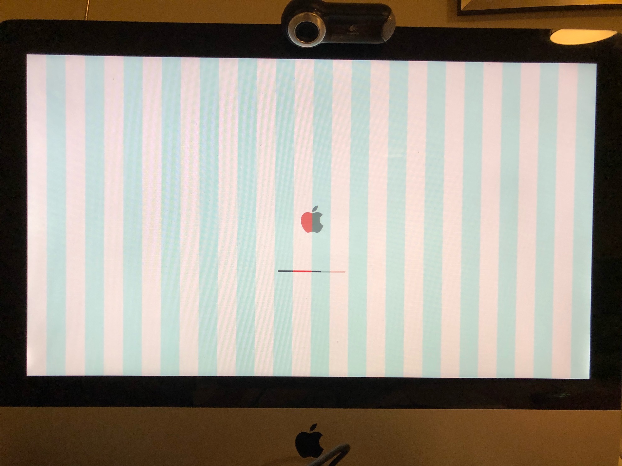

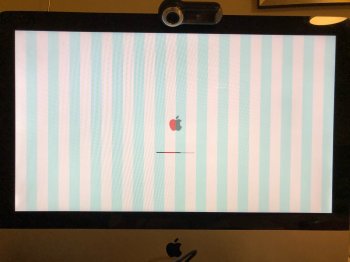

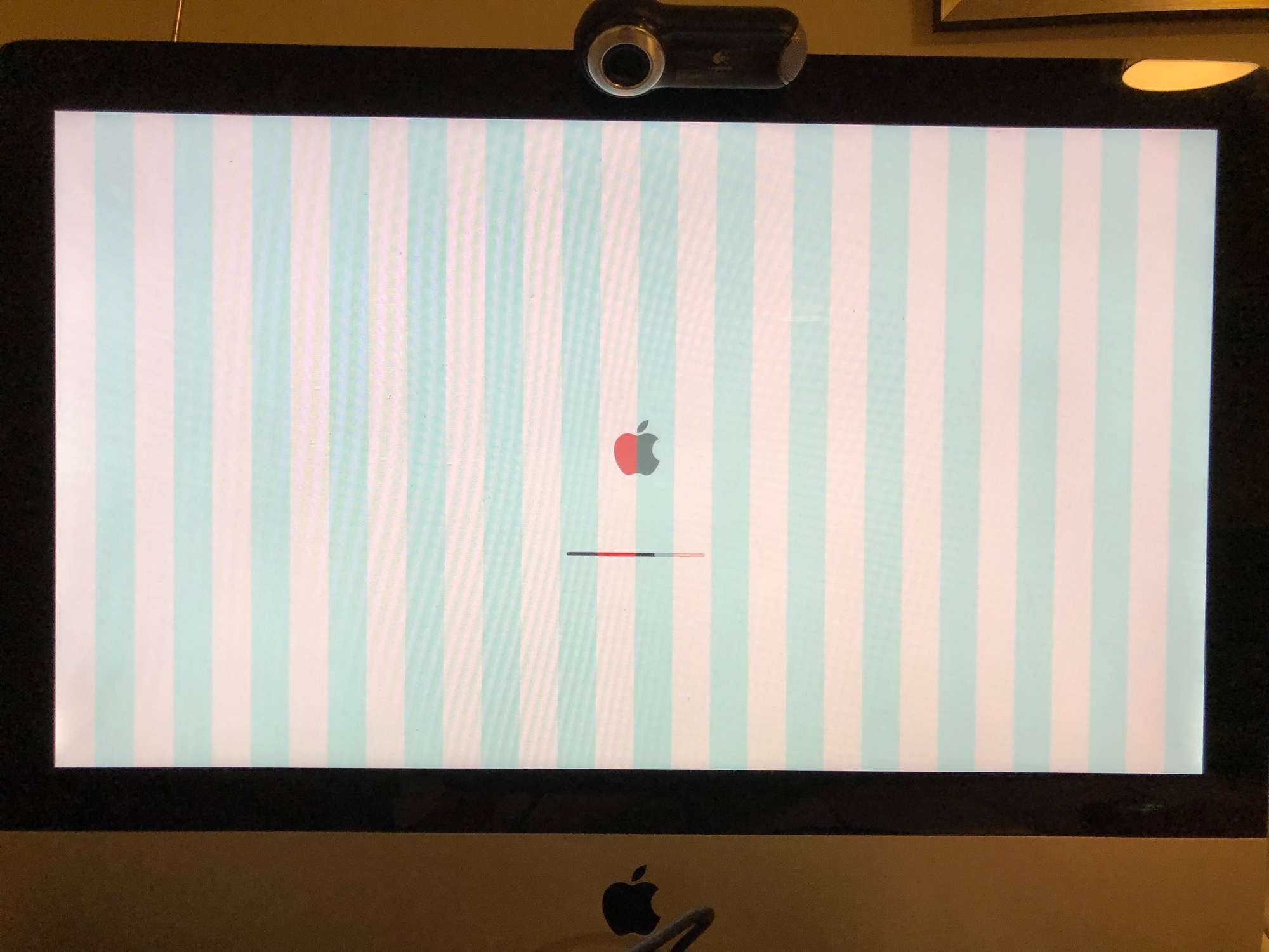

tonight, my iMac sounded a startup chime spontaneously and tried restarting. It started up with vertical light blue stripes, see below. Anyone had this happen before? If so, how did it get fixed, if at all.
I would say it's the GPU. We've had 2 fail within weeks of each other that display these exact same symptoms. Not a cheap fix.
We did, yes and it was the GPU. £400 part.
