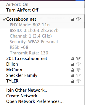

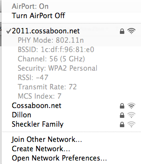

I AM having an issue.
I have 2 Wifi networks in the house.
1 - Airport based thus 'n' cossaboon.net
2 - Non - 'n' a/b/g 2011.cossaboon.net
When connecting to the 'n' network I can ping devices in the house, no dropped packets. When I move to the 'g' network, I drop packets, AND it shows as 'n' on the iMac. Based on the channel and frequency, I think it is a not N.....

On 2011.cossaboon.net
Code:
15 packets transmitted, 12 packets received, 20.0% packet loss
round-trip min/avg/max/stddev = 1.547/94.187/301.253/103.372 ms
on cossaboon.net
Code:
12 packets transmitted, 12 packets received, 0.0% packet loss
round-trip min/avg/max/stddev = 1.747/3.929/12.672/3.554 ms
Kinda fixed
Called Apple
Boot from System install DVD
repair permissions
boot onto HD
Now it joins the 2011.cossaboon.net network at 2.4ghz not 5ghz, and no dropping packets.
I could still have a 'a' network issue, but I am rolling....
