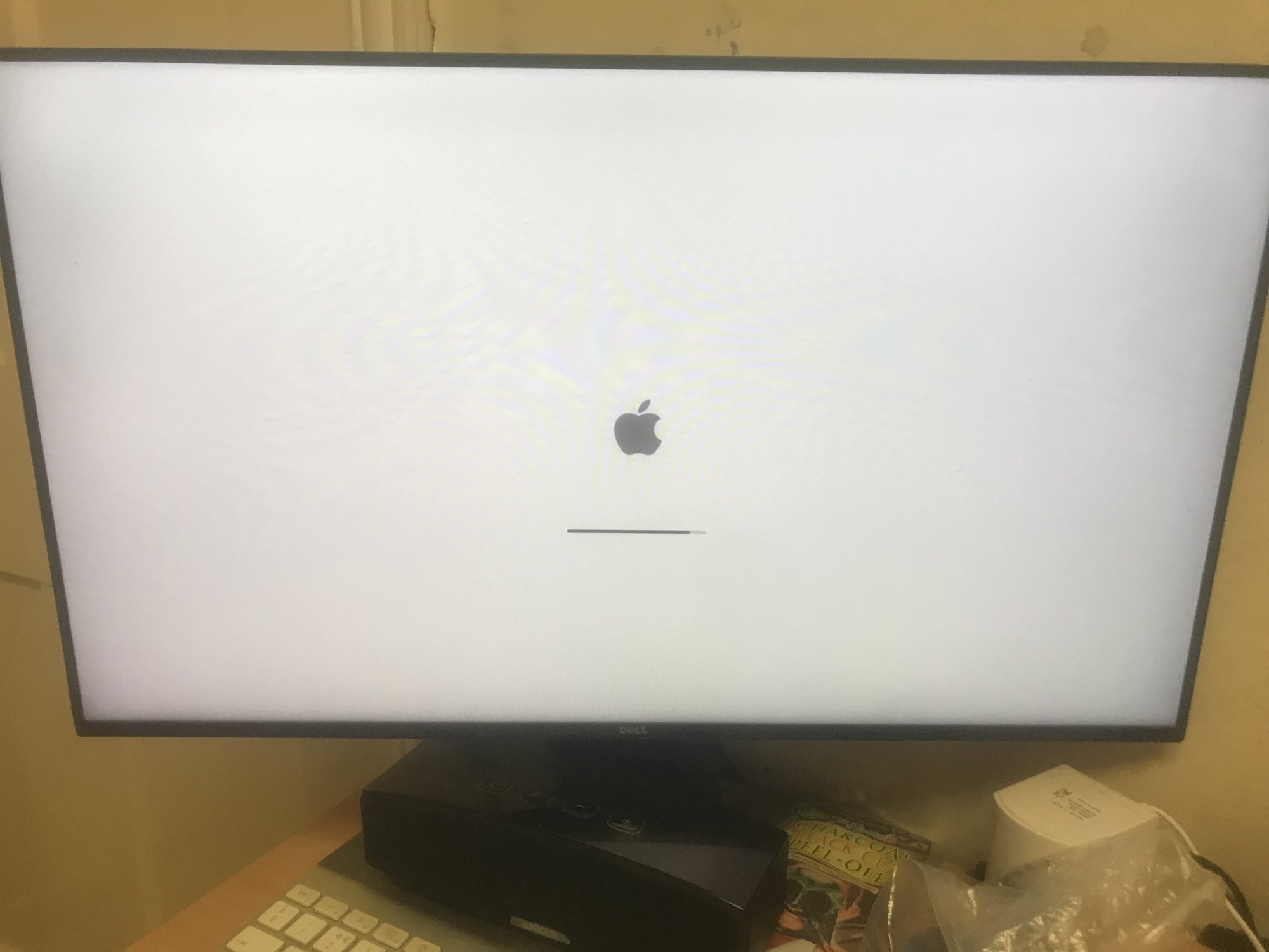

I have a 2011 Mac Mini which doesn't want to boot up anymore. It gets to the screen below then it just shuts down.
I tried to start in safe mode but it doesn't even get to that unless am doing it wrong.
Am running High Sierra with a 1TB HDD main drive. I have approximately 3500 music albums with a few 100's of films on it without back up that i really don't want to lose.
Prior to all this, the Mac Mini was running abit slow so I'd rebooted it and now run into this problem.
I took the HDD out and put it in a external enclosure and plugged it into a Linux Mint computer, It did let me view the main folders but but not my media folders saying that i don't have permission.
Can anyone help ????

The drive won’t let me boot up or even install from recovery. It says the drive is “locked” and that I should reformat to resolve the issue.
I’ve managed to dig out an old hard drive where I’ve installed a new copy of Mac OS and used a HDD enclosure which has enabled me to transfer the media files onto a different drive. It’s taking alot time to transfer 700gb worth of media files using 2.0 USB enclosure.
After it’s sorted I’ll probably put in a 120gb SSD as main drive and hopefully format the current drive to use as spare if it’s still working.
