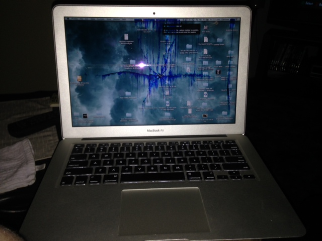

I am reading along with many of the people her because I am attempting a repair myself. I ordered the screen and the glass only parts that were damaged. But if you haven't done it already do not use a razor or sharp tool, the camera wire runs along the right side around the bezel and is recessed in the framing. It is not buried deep in the niche but rather surface flush and could be nicked with a blade or sharp instrument.
2011 Macbook Air Screen!
You said you got your replacement on Ebay? Can you send me the link to the sell or something? I saw someone say their replacement was $70 and ya that is a no brainer however I cannot find the correct part to replace mine..If you can help it would be much appreciated. Thanks again and good luck on your repairs. 😀

Don't use any type of glues or adhesive the actual glass replacement comes with the double sided tape adhered in place when ordered. I did my repair and ordered from a laptop screen website and the glass I picked up from amazon it was cheaper that all other sites and it's original MacBook pro glass.
So I actually did this repair on the 13 and a 15 and both are up and running smooth. The purchase of the screen and glass were more than worth the investment. $130 for both to be repaired and new glass but the second one the glass was not cracked it was ordered as a precaution to me breaking it, but I got lucky.
