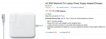

Just do a search on these forums and you'll see the issues that many people have had not using apple chargers,
All the other OEM's charge the same as apple do for their chargers as well, just search the lenovo or HP websites and see.
Basically a good well made well insulated charger that is not a fire risk and protects against surges etc is an expensive peice of kit.
By all means go ahead and do your fix with the toshiba one, however don't say you weren't warned that it was a bad idea, Nobody here will support you in this it is just a fire risk waiting to happen. Also if you can't get an apple charger to last longer than a year or 2 (I have owned a grand total of 2 in five years and both are still absolutely fine what do you people do to them???) your botched effort will last weeks at best...
