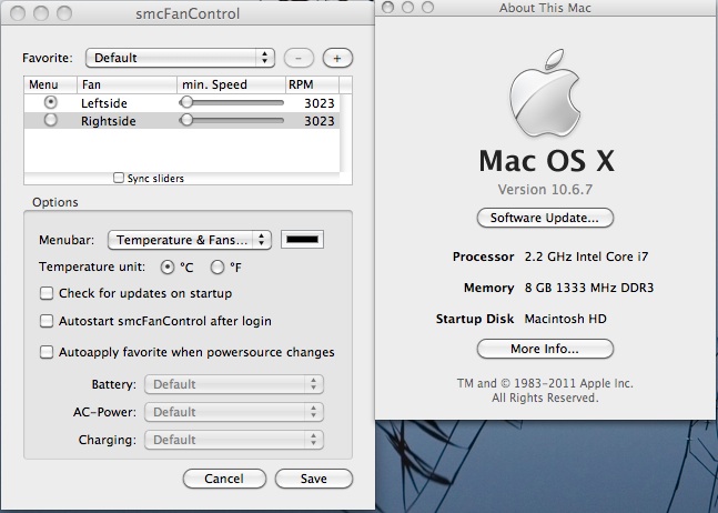

interesting. here's a screenshot of smcfan I took. As you can clearly see, won't go lower than 2000rpm. Any ideas?

you can manually edit the file SMCfancontrol uses to create your own custom settings...but I really don't know why you 2000rpm isn't there by default.
Try Fan Control, which I think is a generally nicer app than smcFanControl. It actually allows you to drop the fan speeds lower than 2000 RPM, then have it gradually increase with temperature, rather than have it hit 90C then the fans zoom up to 6200 RPM. I'm just doing basic browsing now, and my fan is around 1350 RPM, with temps around 50C, which is perfectly normal.
SmcFancontrol I just have settings for 2k, 3, 4k, 5k, and max. If I'm doing anything I usually just leave it on 3k.
I started having issues with smcfancontrol. Before I could go down to 2k, now it won't go below 3k. I have stopped using it, as I have read that I really don't need it. The MBP does all the work and changes it when needed.
