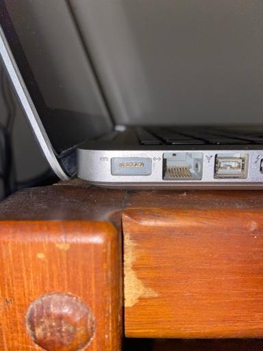

Yup, also tried cleaning out the MagSafe
Also checked the pins. Look fine. Compared to another one for a 2012 as well.

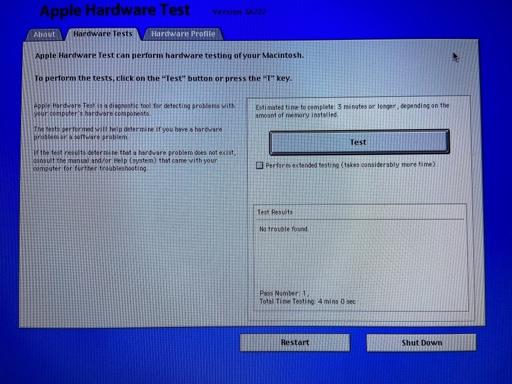

I don’t know how much it means but I did an Apple Hardware Test (saw it testing the logic board specifically) & eventually came up with no faults.

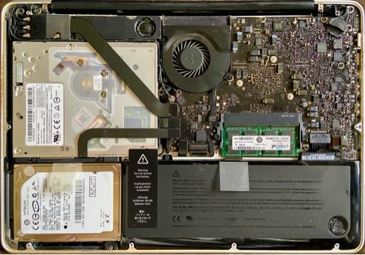

Now tried opening it up and disconnecting and reconnecting the battery. Took the opportunity to clean up inside while I was at it. A little dusty, not too bad.
Put everything back together, did another SMC reset, said a prayer & hoped for the best.
