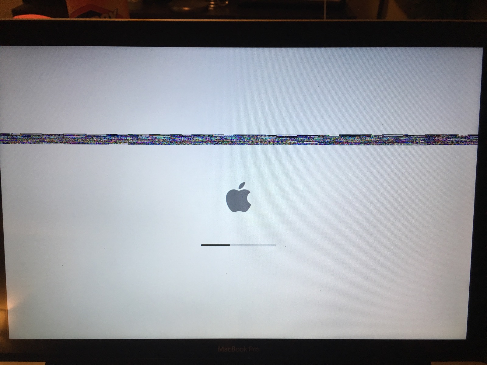

After getting my macbook back I immediately noticed that when restarting it, when the start up screen appeared a pixelated bar appeared closed to the top. It eventually loaded no big deal.

To those of you who've had the logic board replaced did it fix the pixelated bar? I suspect either a bad logic board was installed or just a bad installation. I have an appointment at the apple bar tomorrow but am afraid the issue won't be reproduced or the issue won't show up in their tests.

  • The pixel bar is suppsoed a known bug with sierra?
