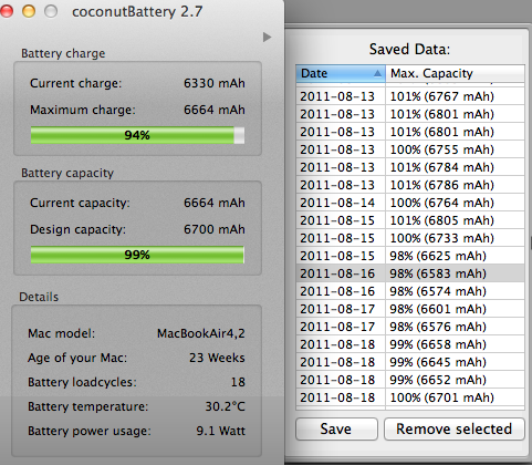

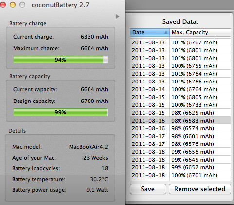

Your battery is normal. The current capacity will fluctuate up and down a few percentage points. It isn't a one way street. I've had my MBA for about two weeks and mine has gone up to 101 (almost 102% darn it!), down to 98%, back up to 100%, and is currently at 99%.
I've owned multiple Mac laptops and it's not unusual to have it plugged in and be sitting at 95-99 percent "fully" charged. Unplug it and let it drop into the 80s and then plug it back in and it will charge to 100.
