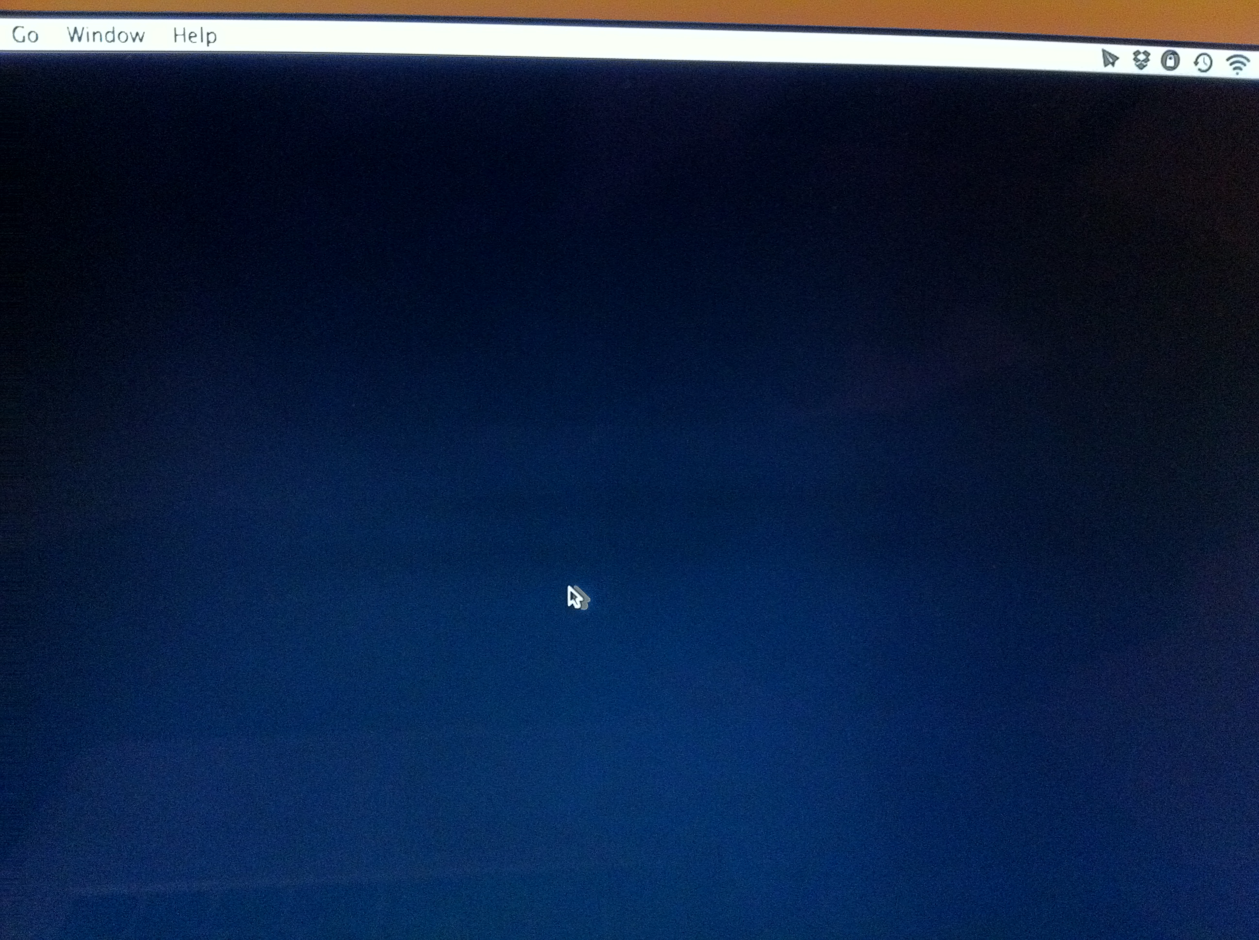

I just noticed this on my 6 week old 2011 MBA (13")
Really annoying seeing as I have a hard case for it (Booq Viper) and rarely stick it in a bag where it is compressed. I'm surprised how fast this happened.
It's only visible on a dark background at certain angles. I noticed it today for the first time when I had it hooked up to my TV watching a movie and the screen was kind of gray/dark but at full brightness. It's definitely not a smudge or anything. At least I can't see it when I'm actually using it, but it's still disappointing how little usage it took to get these marks.
Dark, horizontal lines just above the cursor:
EDIT: See my post here. Apple replaced my MBA today with a brand new one because of this issue.

My 2-month old 13" MBA (mid-2011) base model has exactly the same problem. Presenting this thread to Apple Care guys is a great help to grant me a screen replacement.
I'm in China and when I showed those lines to guys at the authorized repair center in my town today, I was told that Apple China WILL reject my replacement application by saying "it's user's fault to press the screen too hard", as they did in prior cases that "I've seen in a couple of Air's" - said by one of the repair guys.
But when I came back to office I filed a question on Apple support page included with LINK to THIS THREAD and got a phone call from Apple Care. Over the phone they asked me to describe the problem, then they said they had viewed this thread and agreed to grant me a one-time-only free replacement of the entire screen unit (upper half of my MBA) because "there are cases closed with screen replacement in the thread".
