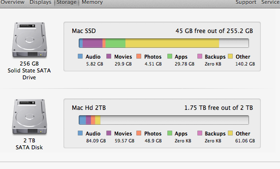

Just fitted a Samsung M9T 9.5mm 2TB to my 2011 MBP 13 into the Optibay chassis. Samsung 256Gb SSD in main(as per last two years)
I've nearly two terabytes free on my laptop now so great for Djing from wav rather than mp3 and for final cut pro projects.

Hi,
Got installed into my optibay last night, only hold up was a stripped screw but dremel sorted that, rest was easy.
Mad thing is that iTunes and iPhoto found all my libraries on new 2TB without me doing anything.
highly recommend the samsung M9t 2TB, has been very quiet and has worked perfectly so far.
one thing i must do is check to see how to enable the motion sensor for that drive as when i first put in the ssd i disabled it.
