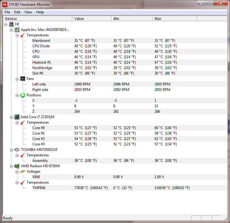

Hey guys, having an issue that I'm hoping I'm not alone on:
I just finished installing Win7 on my 2011 MBP (17") and the GPU temperature is being grossly misreported:
obviously my GPU isn't tracking at 140,000C+, but none of my other Windows temperature monitoring apps seem to be reporting it correctly either. ATI Afterburner also shows similarly ridiculous temperatures. Am I alone on this one or do others see the same issue with HWMonitor?
For perspective: GPU temperature is reported correctly in OS X. This problem is only occurring in Windows 7. The original GPU drivers and the 11.4 beta drivers have been tried. All with the same result.
thoughts?

can you get fan speeds under load? - I've seen evidence to suggest windows only increases the speed of one of the fans.

sure, I'll run the Crysis 2 beta and see what the fans do and post the results.
I'm wondering if anyone else with a 2011 MBP with Windows installed wouldn't mind posting their HWMonitor screenshots (or simply verifying they are or are not getting similar numbers under HWMonitor).
after 30 minutes of Crysis 2 Beta:
both fans clearly appear to be working properly, despite the misreported temp.
both tems scaled back down normall as well. After a couple of minutes, it looks like this:
lol @ the minimum GPU temperature. orly?

i'm having a similar issue... lubbo's fan control reports gpu2 at 90c with an warning looking icon. My mbp feels a ton warmer when I run windows and my fans weren't increasing so I was a bit worried, but maybe its just a misreading? I just downloaded the program you used and i'm showing...

Mine is yes. Has been since the new MBP's were released.
Might just means new bootcamp drivers are needed.
good to hear.
I can sleep much easier knowing it's just a driver thing. thanks for checking, guys.
i hate phones: yes, that's why Lubbo's is going crazy and spinning the fans to max. It thinks the temp is a few hundred C. lol.
