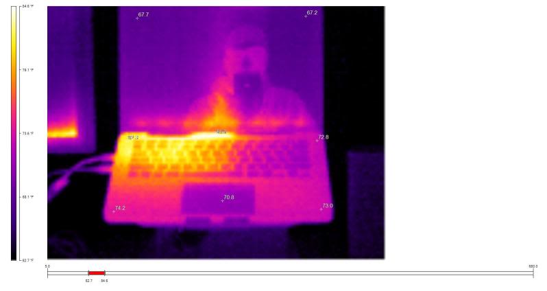

My 2011 MBP core i5 after some artwork using Adobe PS, ID and AI.
This also shows where most of the heat is generated an vented. Pic is a little blurry but it's late and I'm going to bed. I'll post a clean one tomorrow, hottest point is 86.8 in the middle
Interesting heat dispersion even with the heatsink design. Another option if your a DIY'er is to replace the thermal compound on the cpu/gpu. Great writeup can be found in this post
