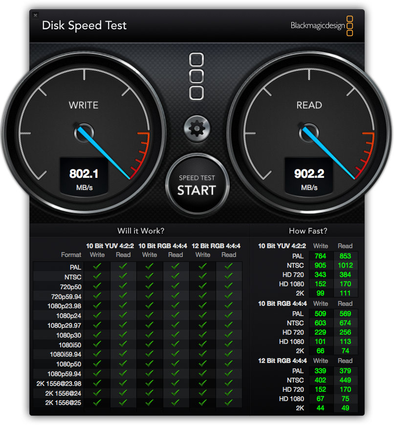

I considered to use a RAID0 to improve read/write speeds further; that did actually work well (see pict), but to keep administration (backup etc.) easy, in the end I preferred to have a bootable backup-clone right within the MPB (in addition to some external HDD staying at home). Another option would be to use Time Machine towards the second SSD (making it a fast process).

OK, here's the result of the RAID0:

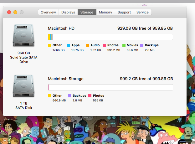

I bought the MBP on shopgoodwilldotcom for around 220 bucks and then brought it to Apple store for the logic board replacement program. once they completed I placed the SSD and 16Gb memory in her. Recently purchased an awesome set of headphones and decided to take advantage of flac files and learned I needed more space. My original plan didn't work so now I have a 1TB SSD as the system drive, and the 1TB HDD as the storage. Im getting 490/540 Write/Read on the SSD in Blackmagic and 110/110 Write/Read on the HDD which so far, seems to suffice for flac playback (The Definitive Technology Symphony 1 has a built-in DAC so I can bypass the MBP and send digital signal straight to the cans from USB letting them process the audio stream) Its nice opening up "About this Mac" and seeing the below 🙂
