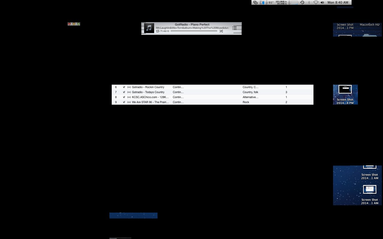

Every time I log into my Mini, the screen is black except for where there is activity (mouse, scrolling iTunes info window, temp, etc). This started happening about six months after I got my Mid 2011 2.3Ghz i5/HD3000 Mac Mini, (about 2.5 years ago or so). It's used as headless media server and nothing else seems wrong, but it's still driving me nuts every time I log in. Temps are normal, nothing over 120-130. I've taken a screenshot. I have never had this happen to any of my Macs over the years, and system upgrades don't seem to help at all. Do I need to pull it apart and reseat the heat sink, or has anyone else heard of this?

No, I haven't. Good idea, but it's not that the updates are slow - it's as if they aren't drawn at all unless I move the mouse into the area or change the position of a window. Is that normal if there is no display hooked up?
Upgrades wouldn't help. It looks like it could be a hardware problem. Parts of what should be within the framebuffer aren't being drawn. I doubt reseating the heat sink would do anything, although it would be interesting to know how this turns out. I don't read about too many mini failures, but I always figured part could be their lower volume compared to the notebook lines.
