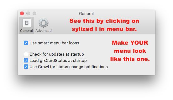

Next: click on General, then check mark the 1st, 3rd, & 4th items only. Uncheck 2nd item if checked.

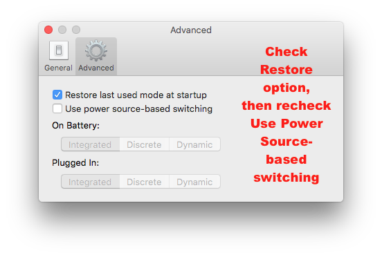

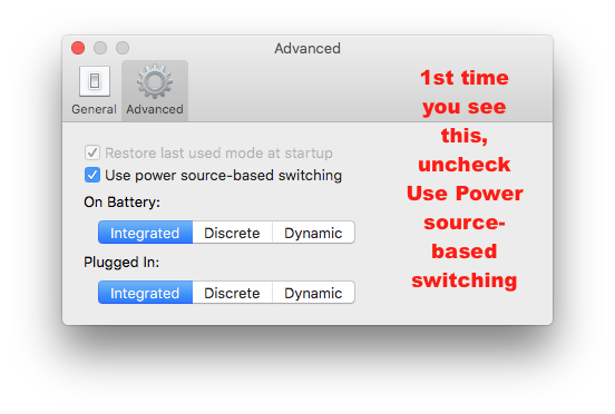

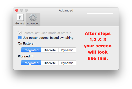

Next: click on Advanced, Now, check mark the 1st & 2nd items. Where it says On Battery: Select Integrated. Where it says Plugged In: Select Integrated. Now the screen has two check marked items, one grayed out, one not. This is as it should be.

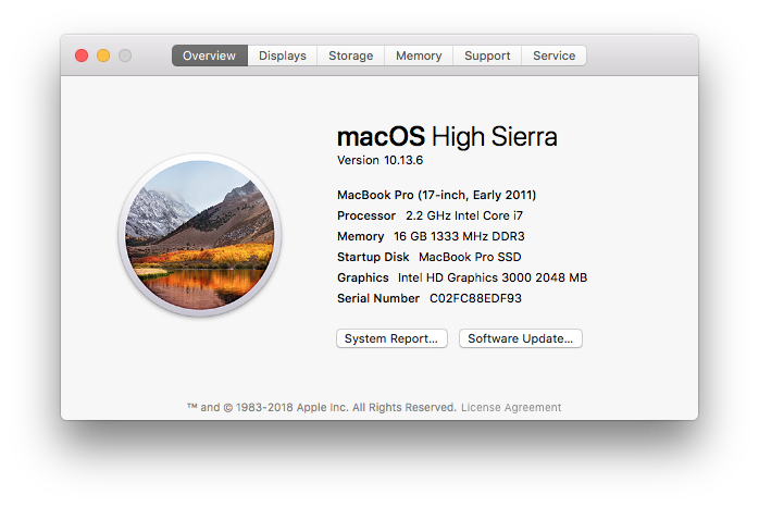

I've upgraded my 2011 - 17" MBP to Mojave. It is an unsupported OS on this hardware. Someone much smarter than I found a way to make it work. DuckDuckGo/Google install Mojave on unsupported Mac for the details.
The point is to show that the computer continues to work. Although the About This Mac screen does not reflect which video chip is being used. According to the System Report the Intel Chip can access a max of 8 GIG VRAM. However it doses not display how much it is actually using. I'll keep you posted.

My 2011 17" is QUITE usable.

Absolutely! Do review my content above and set up the checkboxes and reboot one more time. Assuming the GPU is in fact the problem you will have solved it.

Make sure your battery is GOOD. If in doubt, replace it with a new battery. Our MBP's will not boot with a bad battery, with or, without an AC MagSafe Adapter connected. It just won't happen. I cannot tell you how many hours of "testing" I wasted, because I did not realize my original battery was in fact "bad" or "dead" ...
[doublepost=1566577760][/doublepost]ALSO NOTE: Make sure SIP is inactive. If it (somehow) turns itself back on during all these reboots (It shouldn't but one never knows how it does) your "work-a-round" will not function.
If you have a working 15" or 17" 2011 MBP, you can install gfxCardStatus into the Applications Folder. Configure it as noted above. This may take two reboots, 1) after you install << reboot >> and 2) Configure as noted above, << reboot >>. Upon that reboot, your Intel GFX Chip will be in control. YOU WILL NOT HAVE the use of an external display at this point. Follow the configuration instructions above and assuming the GFX Card is in fact your issue, you'll be good to go.
