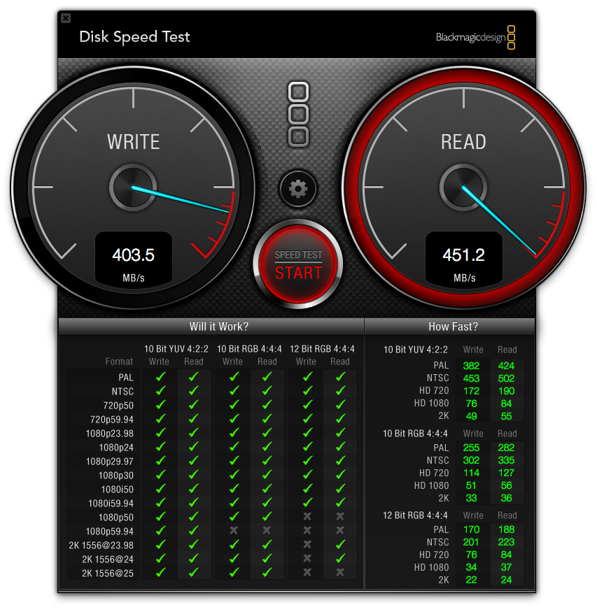

even though I don't have the toshiba ssd, but the 256 samsung one, I ran a test with the app you mentioned for comparison reasons... here's what's going on on my machine.
mba 2012
Code:
APPLE SSD SM256E:
  Capacity:	251 GB (251,000,193,024 bytes)
  Model:	APPLE SSD SM256E
  Revision:	CXM09A1Q
Code:
du -hs /
 37G	.
