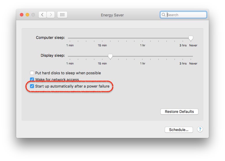

I have a similar issue, 2010 Mac Pro w/2x2.66 and have not been able to fix it. However mine randomly shuts down and immediately restarts. Do you have any error logs for the shutdown?
Sounds like a power failure (e.g. PSU related). If that's due to overheat, it should be a hard shutdown but no auto re-start.
Having that preference checked would restart my computer a few minutes after it randomly shutdown. It's not root cause of my shutdowns as I eventually disabled it and the problem persists so I didn't mention it, but I normally have that option set.
My logs showed no discernible trace or hint of impending shutdown, so it appears that it's occurring from a hardware issue that does not generate log entries or the effect is so sudden there was no time to record an entry.
Oh, sorry, I should be more specify that's reply to nft's case.
