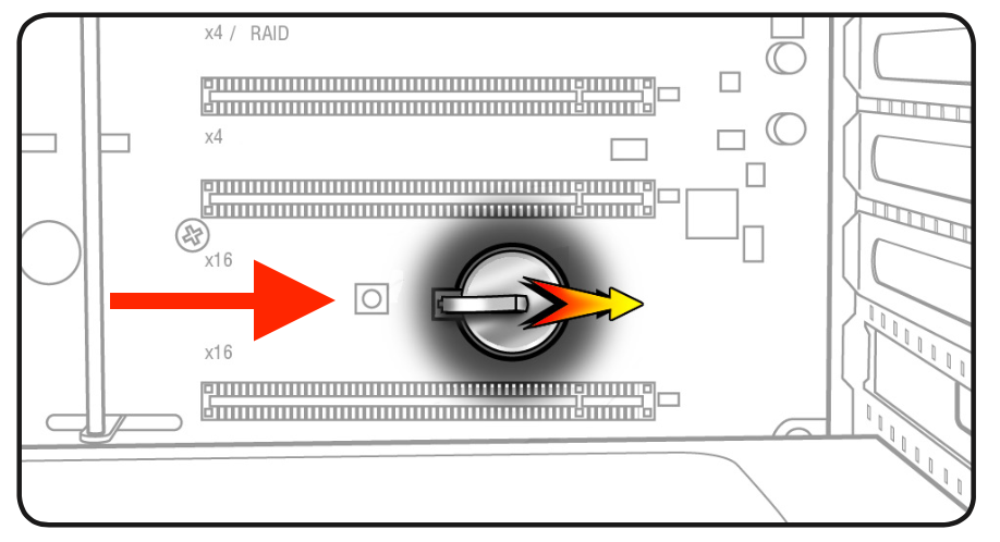

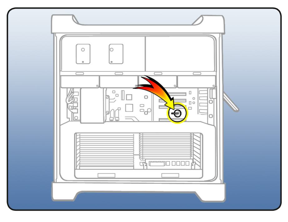

I'm not talking about a MacBook. Press the RTC reset button, near the RTC battery between the Slot 1 and 2.
This is the RTC reset button:
If reseting the RTC won't change anything, try the firmware fail safe mode. Disconnect the mains power cable, carefully remove the RTC battery so you won't break the RTC battery holder, leave the battery disconnected, wait two minutes and then connect the mains power cable. Your Mac Pro will power on automatically, see if you can boot the sure working macOS disk.
After doing that your Mac Pro started with the firmware fail-safe mode and anything that depends on the RTC or the NVRAM won't work, like BT and Wi-Fi. The best macOS release to work with firmware fail safe mode is Mavericks, btw.
