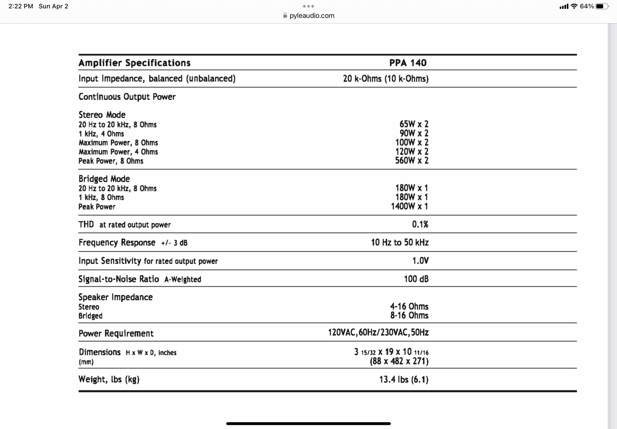

Okay going to bother again, disabled sound app, and still no sound. Any way here are specs on amp. And using RCA plunges are unbalanced.
