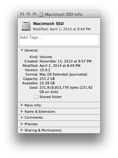

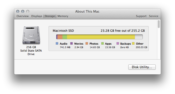

On my 2012 Macbook Pro (Classic, non-retina, 2.7Ghz i7) my boot drive (a Crucial M4 256GB SSD) is reporting a mere 23.28GB of free space and 231.9GB used when in reality I have less than 110GB of data on the boot drive (according to Omnidisksweeper)
I have tried everything I can think of to try and resolve the discrepancy but I cannot for the life of me figure out what is causing it. I've even gone as far as reinstalling the OS (though I did not do a clean install, that is my last resort) and even that didn't address it. There is nearly 200GB of mysteriously missing space from my drive, and I don't know how to reclaim it.
I'm hoping it's just something simple and I'm going to laugh at how easy it is to fix. Any ideas?

I'd recommend running Disk Utility and the "verify Disk" option. I've seen issues with incorrect free space in the past, and using Disk Utility from the recovery partition (hold R at startup) fixes it every time.
Try the disk check dmccloud suggested. If that does not work enter the command below in Terminal then post up the output. This will show the size of all your root folders in GB and we can help you out. OmniDS does not show system file sizes so is not giving you the full picture.

Could be. Usually those Time Machine local backups will show in that purple "Backups" section in OP's screenshot though.
I have seen cases where the local backups get deleted from /.Mobilebackups to /.MobileBackups.trash and they get hung up there. Then the purple shows zero put we have space used in /.MobileBackups.trash. Read my post #11 in this thread.

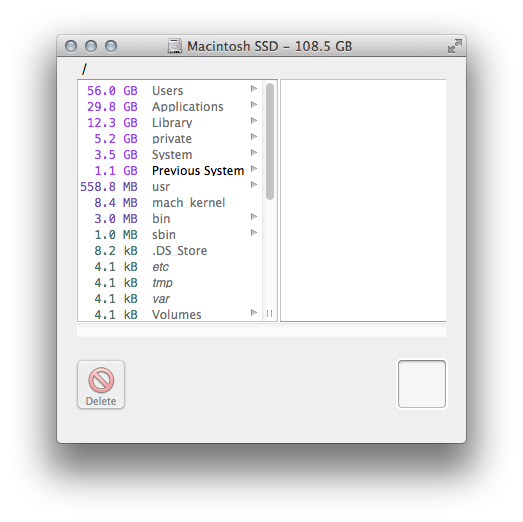

OmniDiskSweeper does indeed show all directory sizes. Local Time Machine backups, however, are shown as a separate volume.
I'm not sure what you are trying to say. Go read the thread I linked and my post #11 in that thread. I posted screenshots in that thread showing OmniDS does not show the folders we are discussing here, as well as other hidden folders such as the Spotlight index.
The hidden folders /.Mobilebackups and /.MobileBackups.trash we are discussing here are not separate volumes, they are just hidden folders.
They are not shown by OmniDS and they are shown by the Terminal command I posted.
If you run OmniDS as root with this command, then you can see those hidden folders.
