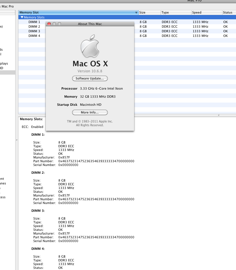

I'm another with 4x8GB sticks, all four running at 1333. I bought mine from OWC, and it's ECC.
Here's an old screenshot:
mac pro / Xeons does not require ECC, it simply offers the possibility to use it. mixing ECC with non ECC is not a good idea tho.
