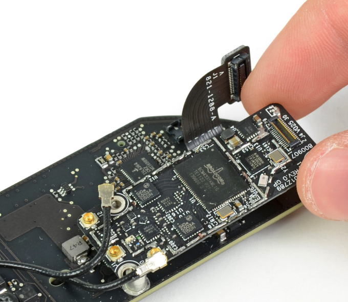

My Mac Mini connects unreliably to wifi network. Slow to no connection. When a usb drive is attached connection degrades to nil. When drive is removed the connection is flakey: could be very fast and then drops to dial-up speeds. Other Macs on the same network connect at close to nominal fiber speed. Apple told me to upgrade OS and see. I tried downloading OS installer, installing on external drive, and booting from same. Could not connect, so I conclude software is not the problem and tat maybe USB is starving wifi of power or wifi unit is bad and that is why wifi connection fails.
If USB is fried does that mean I need a new system board?
If wifi is bad, that subsystem can be replaced. Correct?
Fortunately I have Applecare. I'm hopeful they can fix my mini since it has upgraded RAM and drive.
Any insights appreciated.
I also have a 2012 i7 Mini. I usually don't use the WiFi although when I do, I don't have a problem.
The USB drive issue could be interference. Actually, the WiFi issue itself could be interference. I'd try to reduce possible sources of interference (nearby USB, Bluetooth, other wireless sources) and try it again. I don't recall anybody on macrumors having a WiFi board power issue.
If the drive was upgraded recently and you have had the problems since the upgrade, then it could be that something wasn't done correctly in the upgrade. If you have AppleCare, I'd take it in and have it looked at. At the very least, they should be able to figure out if it's an interference problem. As I recall, some people have had problems with Apple repairing the Mini if the drive has been replaced, others not. There are two components to the WiFi - the antenna which is attached to the grill and the Bluetooth/WiFi card. One place was selling the Bluetooth/WifFi card for $80 new, FWIW.
https://www.ifixit.com/Guide/Mac+Mini+Late+2012+AirPort-Bluetooth+Board+Replacement/11709
Thanks. Good to know that wifi can be purchased at a reasonable price. I don't know the drive history as it was bought used. 1TB +240GB micron SSD forming fusion drive. Tested fine with many repair/diagnostic utilities which checked hard and software. The wifi diagnostic wizard from El Capitan generated a report and seemed to agree with your hunch that it's interference, advising that I switch channels. There are iPads, iPhones and Macbooks all in proximity, as well as a wireless printer. Also several neighbors' wifi networks visible and strong. Only the Mini has a problem. Unless these are known to be very prone to interference I have my doubts as to that being the cause, however it's certainly something to eliminate as a cause.
So, I presume you've recently acquired the Mini. In which case, given that the other devices don't have problems, I would suspect something is wrong in the Mini. It could be the drives causing interference although there's not a high likelihood of that. If you have the original Apple HDD (you can use System Report to find out), the chances are even less so. That being said, it wouldn't hurt to research if the Micron or the HDD (if it isn't an Apple HDD) has reported issues with interference. More likely is some problem that was introduced when the SSD was installed. Besides the card, there could be numerous other issues.
A good number of people have broken something or other in doing a drive replacement in the 2012 Mini. If you don't feel comfortable with what I'm about to suggest, don't do it. With that caveat, it shouldn't be difficult to just check the WiFi antenna. In the ifixit URL I gave above, it shouldn't be difficult to do steps 1, 2, and then steps 8-10. You can see if there is anything obviously wrong, particularly with connector (step 10). I did the drive replacement without breaking anything, BUT ... I found that I couldn't put back one of the outer screws on the antenna. Whether mine was originally jammed in there to begin with, who knows. (I haven't had a problem with the lack of one screw.) If you're missing a screw, then you know that's likely what happened. It'd be very difficult to change the drive without removing the antenna so if both of the outer screws are there, then you can proceed knowing it's likely you'll be able to put them back again as well. Beyond this, diagnosing gets more difficult. If you go that route you can re-trace the steps using the iFixit guide.
EDIT: You're going to need Torx screwdrivers as noted in the iFixit guide if you do steps 8-10.
EDIT 2: As I think about it, a viable alternative, given the circumstances, is a USB wifi adapter.
Intel wrote a paper on the issue of usb3 interfering with wifi. Then OWC came up with a small sticker(?) to block interference. Cost. 10-20 dollars. i have the same machine but have no wifi issues. I only use usb3 when backing up machine. Thusnever encounter the problem. Best. Elo

Thanks for all the share experience and comments. Since the machine still had Applecare I took it in to the local Apple Store. They ran some tests and finally just replace the wifi card. I'm now connecting to my wifi network and browsing the web at full full speed, so that must have indeed been the problem. I found the comments about bluetooth interference interesting, as although my wifi is completely fixed my wireless keyboard/mouse will not connect now. I'm in the process of checking settings and will try deleting, adding and re-configuring them as they worked perfectly before.

How is that Mac mini doing macmesser? I do not think that you should go beyond deleting and adding those Bluetooth (BT) accessories. I also suggest that you avoid technical diagnostics such as power supply checks. 😉
You say that your Bluetooth problems started after the repairs correct? That AirPort/Bluetooth card contains radios for both networks. If Apple just replaced the WiFi card under Applecare then your wireless networking features should be covered! Don't check or change anything other than your batteries and BT connections. Perhaps that card is defective or they left an antenna lead loose. Either way Apple can find and fix the problem under warranty.
You should box up the mini, mouse, and keyboard and hustle over to Apple immediately if you have not already done so. (Or unless reconnecting the BT controls (to the new Airport/BT card) solved the problem!)

Thanks for replies. I eventually got keyboard and BT mouse to connect and the wifi seems to be working well, if somewhat slower than my 2009 Macbook. It was strange that the BT devices wouldn't connect at first. The second time I went to the Apple store they reinstalled the OS and afterwards devices connected. I think there must have been some corrupted or erroneous settings which were eventually overwritten. The wifi connection speed in my environment is still not quite as good as my 2009 Macbook running the same OS, but not all systems are going to perform identically. Also, the fact that connecting a drive to the USB 3 ports affected wifi speed is still unexplained. (I have not adequately tested this issue since my last visit to the Apple Store. I have until June with Applecare so I will keep an eye on things. Could possibly be on board USB 3 problem.)

Pairing works and keyboard/Apple mouse work fine. Residual issue is USB 3 drive still seems to cause WIFI slowdown, but nothing like previous where it "froze." Hard to quantify this effect. It's possible this is to some degree normal for this system, I guess.
I've read the Intel white paper on USB 3 drives interfering with BT. Granted the white paper is about BT and not Wi-Fi as someone already mentioned, but they are the same frequency. One of the fixes they mention in the white paper is to wrap foil around the USB 3 cable's connectors (get as close as you can to the port). You might try that as it is a quick and easy fix, to see if it improves anything.

Thanks for the tip about shielding the cable, which gives me another idea I'll get to. Will definitely give the tinfoil wrap a shot and also see if there are any super shielded cables available. Very interesting to learn that wifi and BT frequencies are the same as it dovetails nicely with an observation I made a few days ago. After recently getting my mini back from two Apple Store visits to replace the wifi card and then confirm and tweak problems, I was slightly horrified to notice that even with no USB device attached the wifi speed was impacted by BT, increasing when BT was turned off and wired KB/mouse were used. It's much worse with USB added but quite noticeable without. Moreover, the mini at its fastest and with no USB devices AND BT turned off, connects to the same wireless network from same physical location at between 30% - 80% (at best) of my 2009 white Macbook (which connects at almost nominal Cablevision speed). The Mini also is much more affected on upload speed which seems strange. Since the Mini has much better specs it should be at least equal to the Macbook.
All of this makes me think that a hardware design problem with this model (possibly the wireless card) could exact a hit on wifi performance, which is accentuated on a relatively fast internet connection. The first Apple tech I spoke to seemed to think it was a software problem and after urging me to upgrade to El Capitan (I didn't) ran a proprietary utility which cleaned out certain caches and stored data. This improved things, but very temporarily. So on the hope that software fixes have been developed I will go for El Capitan and incur some software replacement costs. A second possibility is that the observed effects are unique to my machine, indicating a bad card (unlikely, as newly replaced) OR system board damage (I'd be screwed but don't think it's the case), OR problem caused by improper/incompatible upgrade to fusion drive by adding Crucial SSD. This last possibility is interesting. Maybe adding shielding around the SSD and HD will help. It seems reasonable that an SSD could be emitting a lot more RF than a HD would. So I need to figure out how to build a faraday cage around the fusion drive. I wonder if there's such a thing as insulated foil or thin gauge metallic fabric. Could putting shielding around drives cause overheating? Maybe simply repositioning the drives would help.
