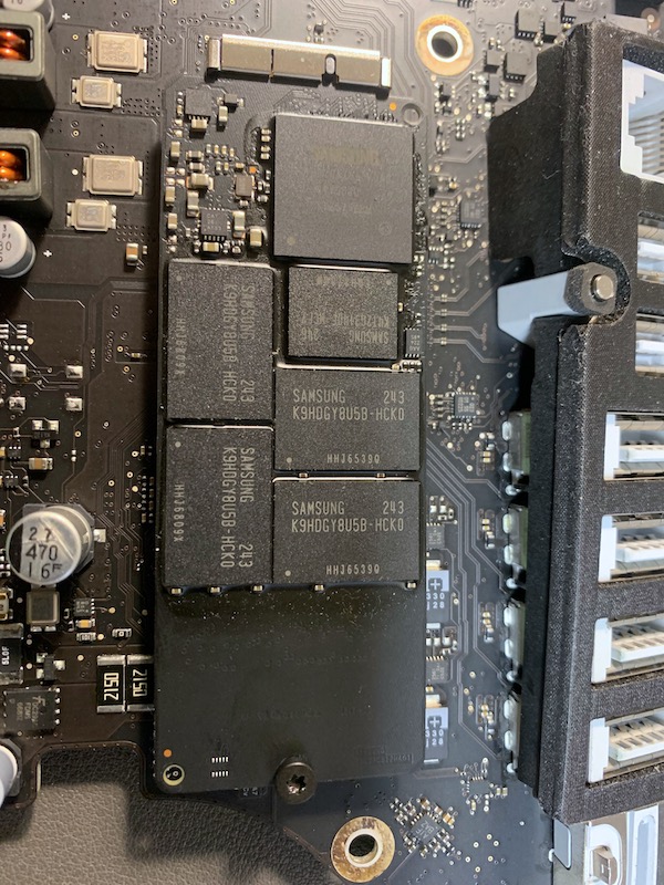

i'm about to open my Late 2012 iMac 27" to replace the fusion HD with a single 1TB blade SSD (w/Adapter). I will be ditching the mechanical drive and will not replace it with anything. I intend the pull the SATA cable out as well.
Any issues with this plan? does the iMac need a physical drive attached to SATA cable?
My advice is to go ahead and replace the SSD portion of the fusion drive with the blade SSD.
BUT...
There's no need to remove the platter-based hard drive.
Just reformat it and use it for extra storage or perhaps as a bootable backup (in case the blade SSD ever fails).
Two drives are ALWAYS better than just one.

Your 2012 model probably wont be able to take the advantage of any modern NVME blade Flash Storage, so I would not bother with higher complexity of replacement and instead, stick with a regular SSD in place of HDD and call it a day.
I had 2012 model and had Samsung 850 Pro and had no issue and the performance was day and night compared to spinning HDD, but mine was HDD only, not Fusion.

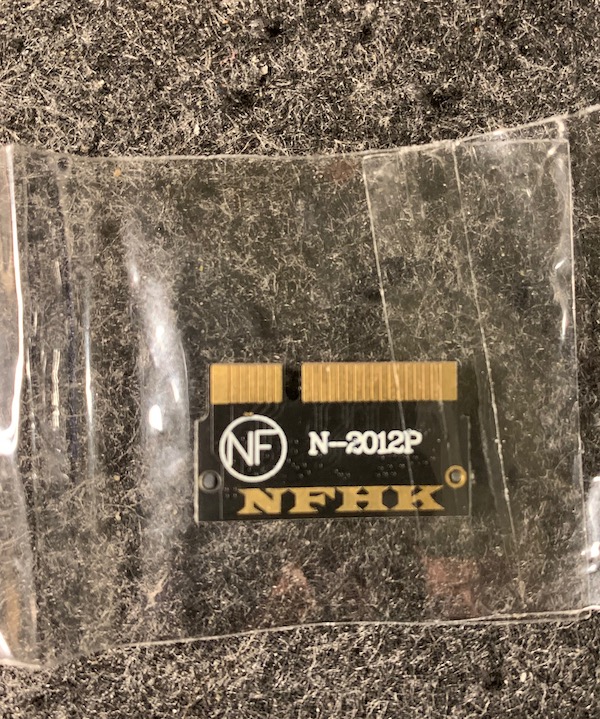

first off, thanks guys. I've spent a bit of time last night (a lot) and got the upgrade done.
Everything is working well except for the fan as Juicy Box said. I Have the screen being held by painters tape until I decide to seal it up. Honestly, not interested in spending another $35 on OWC temp control sensor, so I may short the SATA cable or ditch it since its only connected to a spare 128gb SSD.

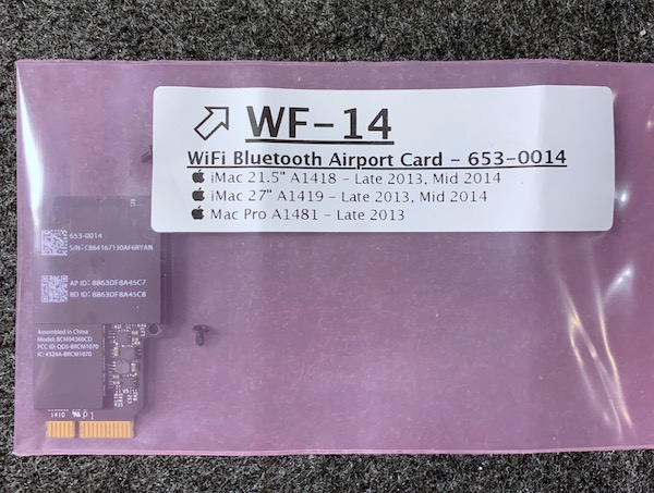

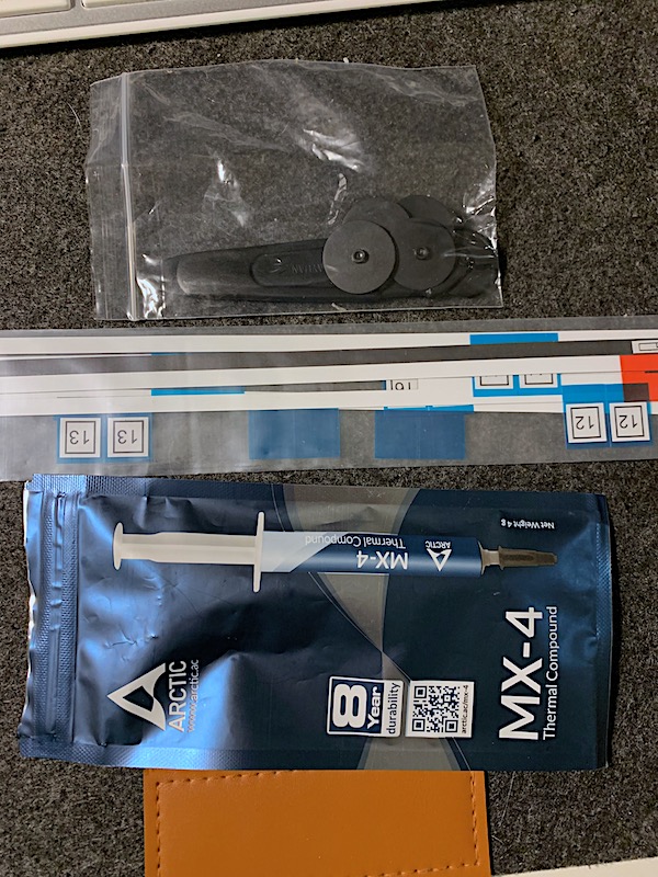

Here is what I used to upgrade...which included a new WiFi/BT card from 2013 iMac and new termal paste on GPU/CPU.

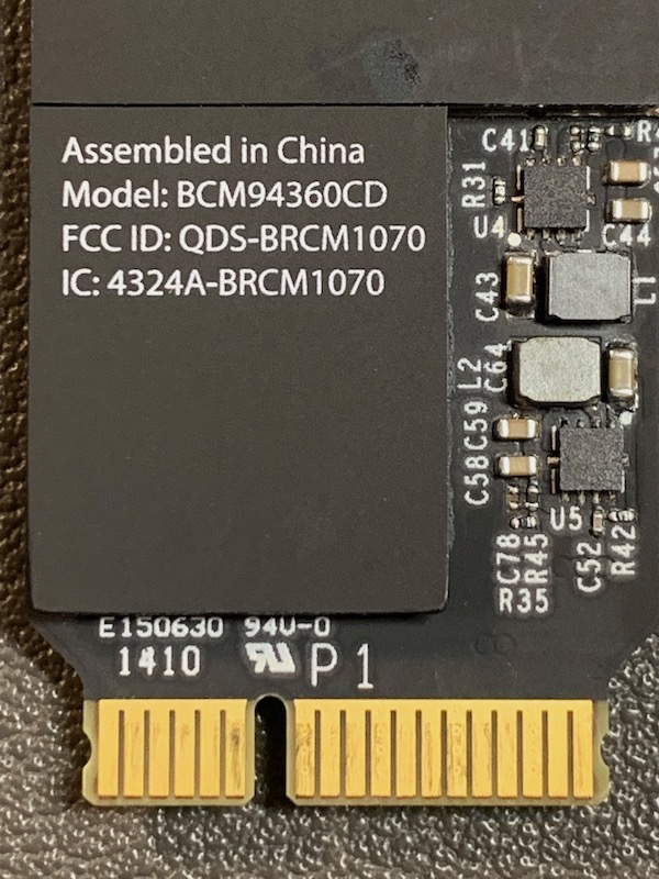

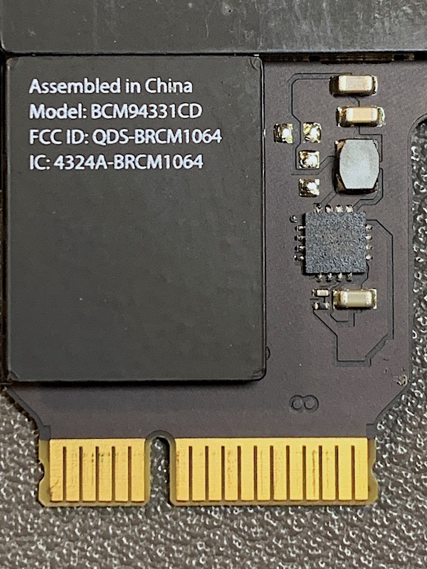

Here is the original Wifi/BT Card...
The updated 2013 version....wifi speeds way up, and unlock with Apple Watch now works....it was a pain however to re-install new OS, had to borrow PC wired keyboard and mouse during install.

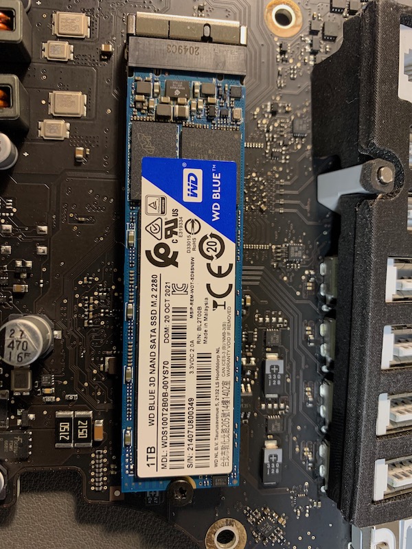

The blade M2 SATA SSD fit perfectly...Speed test over Fusion improved, but not a bid deal..Write speeds went from ~250Mb/s to ~400Mb/s, read speeds slightly less improved.

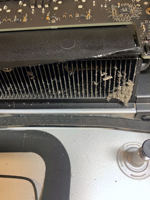

One of the other reasons to open up the iMac was to clean it out.....this is not even the worst of it.

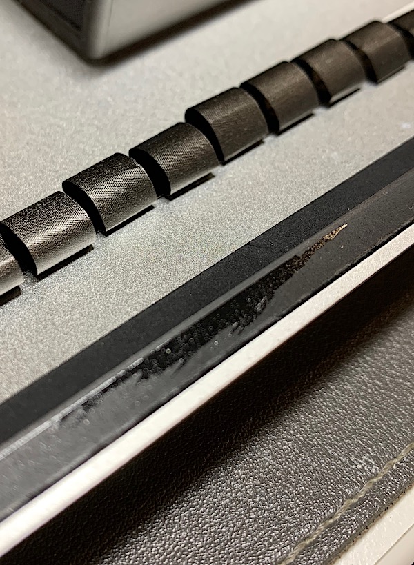

General tip for those opening up the iMac and having some difficulty with adhesive strips...after pulling off the factory adhesive strips there will be residue left behind....this needs to come off to get proper adhesion. Between goo-be-gone and rubbing alcohol it will come off.
