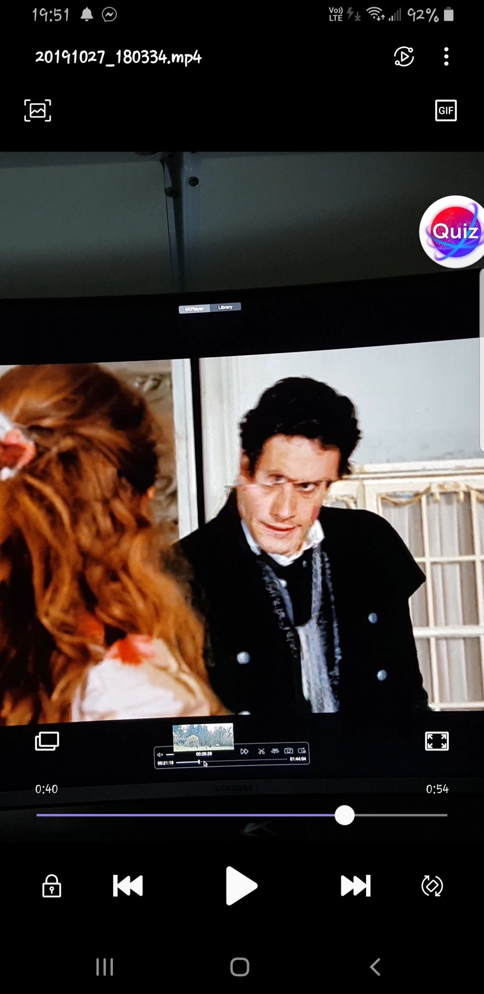

The monitor is brand new, but I did try several cables before I settled on the current one, it's a minefield with these cables.
Maybe have to keep on searching for the perfect cable ?
Have attached a screen grab to try and show the rolling effect I said about
