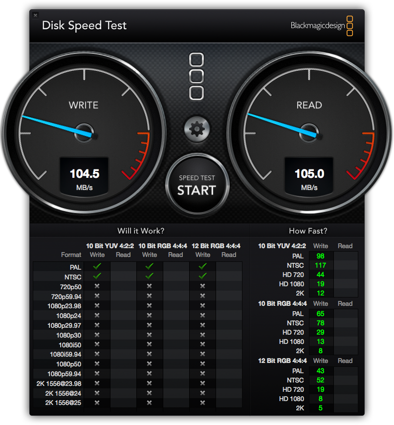

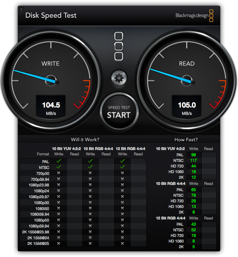

Here's some BlackMagic DiskSpeedTest results comparing the stock internal 5400 RPM drive (first) to a Toshiba Canvio Basics 1 TB USB 3.0 external drive (second). Pretty close in speed!
Other than having the drive tethered externally, is there really any other disadvantage to having it external vs getting a data doubler to use the internal drive? I am planning to install the SSD drive internally today or tomorrow and replace the stock drive.
