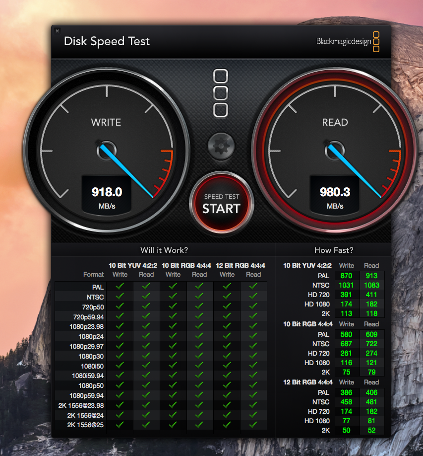

Just received my 2012 Mac Mini Server model
remplaced immediately stock HDDs by 2 Sandisk Extreme Pro SSD 🙂
remplaced immediately stock HDDs by 2 Sandisk Extreme SSD 🙂
