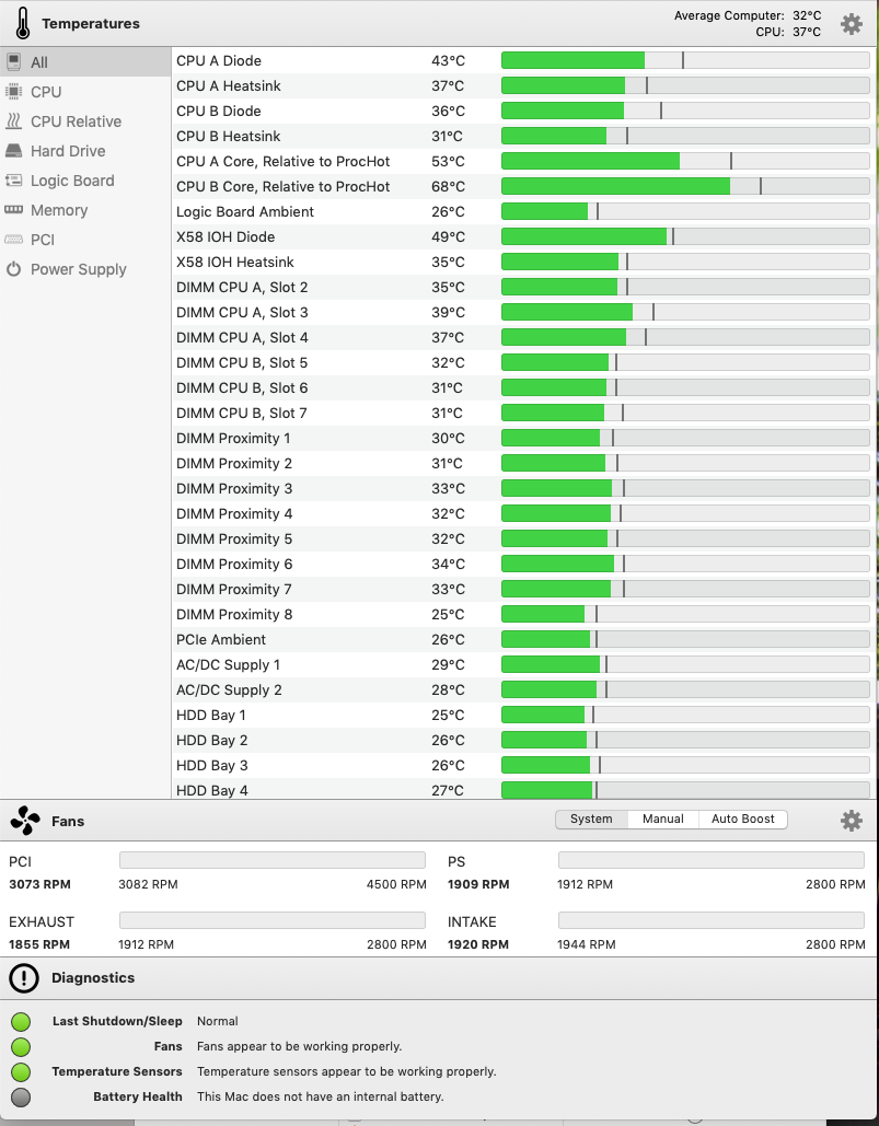

download macfancontrol if you haven't already and monitor temps the dual cpu northbridge tends to run high due to a faulty spring (someone feel free to correct if wrong) You can buy like a $10-15 kit to replace it or I just increase fan speeds slightly to attempt to keep it under control for longevity
Thanks for the suggestions. I will reinspect slot 1. I am running TG pro to monitor temps and running fans st 25%. Temps seem okay, in the 35-45°C range for the cpus and maybe 45- 60° for Northbridge, but cpu A is running hotter at the high end of the range. I did replace the pins on Northbridge first, it was difficult to get the pins in and secure to the board so the paste possibly could be re-done with better technique.
I have attached a screenshot of the TG Pro temps. The temps are all running in the 35 to 50C range.

If you need to take it apart again, take a closer look at Northbridge, this seems to be a little high delta.
Keep watching Northbridge, temperatures should not spread wider than yet. NB can run hotter but the delta between chip and heatsink should not rise.

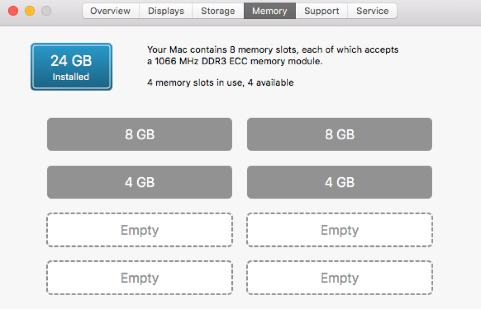

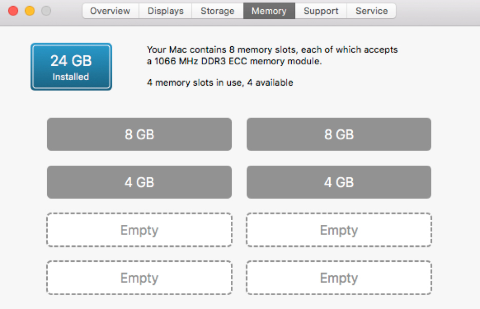

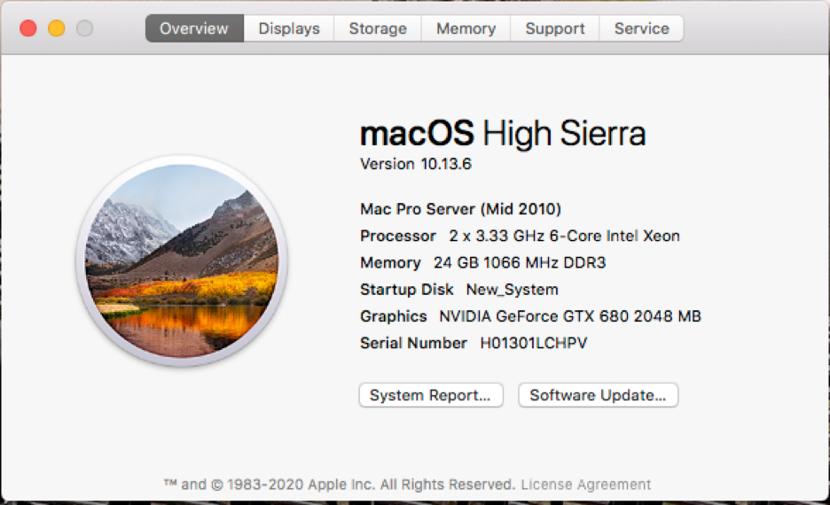

I want to add my 2¢ I have a 2010 Mac Pro that had a single CPU and did buy a dual off eBay of one that CPU B did not work after the fellow had repasted and upgraded the CPU's. He would accept an offer and he had images of the CPU sockets and nothing stood out as smashed pins. So I took a chance and figured I'll accept the challenge. I received the the dual CPU sled on the 12 of April 2021. So I took it apart cleaned it up it was not really that dusty or dirty. I decided to take the Northbridge apart and sure enough that paste was dried.But I did look on ways to replace the pins and found two of them. When I ordered the plastic type I did not realize they were coming from China. So as they were on a slow "boat" I decided to do the second one with screws, nylon washers and nut plus drilling a small hole in the sled.
I inspected the the CPU B socket one pin stood out it was askew and I used my Camera inspection of sensor thet has a magnifier and led lights. I was able to adjust it. It seemed no matter how careful I was installing the the heat sync on B it was never quite right. I don't remember the times I tried counting I was doing some thing wrong. The sled would not boot totally as I could hear access to the DVD. No error led I even changed the 2032 battery. Now if I remove the B cpu A would boot up with the fans at full speed like the tech manual says. I even ordered a another CPU in case the one did not work. You put them in socket A they all worked, so back to the pins. I did price out what a replacement socked would cost. Finally I decided to pick up a Toy Video Micro Scope and that really helped as I located 4 pins elsewhere that were not aligned. I was able to tweak them. So I put the heats sync back on but still no boot or any errors. Remove the CPU Heat sync BUT leave the CPU B in if it over heats it will shut down. So I tried just CPU B no heat sync and it booted but shut down before the log on screen. Now this is where gets strange I put the heat sync back on no boot. SO what do I have to loose I loosen each screw a ½ turn install the sled no boot. I am not sure how many times ½ turn loose I did but it booted!! I ran tech tools and even have iStat Northbridge is around 55ºC and the CPU's run around 40ºC I had it running for 5 hours but nothing broke and seems stable I have rebooted several times. I did get the sled with the CPU's for 230$US plus 15$ shipping. I will update later.
