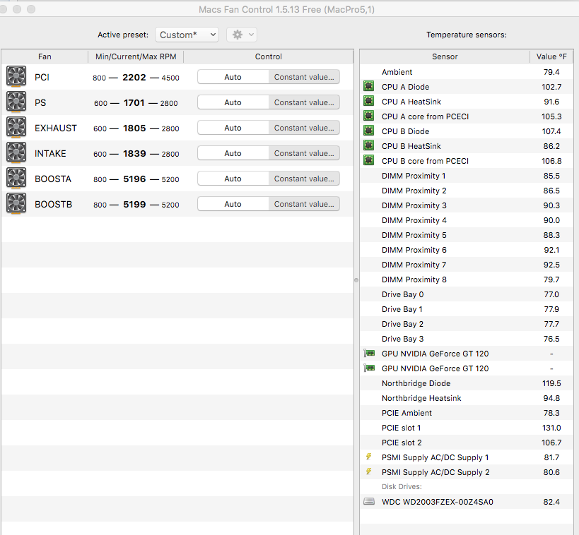

Northbridge is running at 120 farenheight and around 23 degree difference
between the heatsink and the diode
diode around 97 degrees
It's a forum convention to use Celsius for temperatures, no one outside USA will convert it to see if your temperatures are good. All forum posts that talk about expected temperatures are in Celsius.

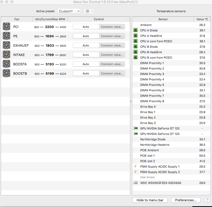

so Northbridge is running at 48.89 c and the heatsink is at 36.1
Are you sure? These are temperatures for winter over the Arctic line 😉 For most people over the world, the heatsink diode will be around 72 to 75ºC.

heres my fan control specs
I have reformatted a new ssd and did a fresh install of 10.13.6 and everything is working as intended now, thanks so much for the advice, spent hours listening closely to make sure no glitches ...mouse is operational and no spinning beach ball !! YEAH!!!!
As for the fans I run much colder than everyone I suppose , but my theory is cooler runs more efficient
I'm not a gamer I'm a recording and repair combo guy but the price of a new silent running fan is cheaper than other potential components that could fry . I had a Mac overheat and die with only SMC operating which is one of the reasons I use the macsfancontrol among others ..... so twice shy I suppose..... but if a new fan is all I need to fix ....I'm good.
Thanks again for your kind assistance you've saved my studio and repair space and I'm ever so grateful!!

But you can not buy a simple Fan, because apple is using non-standard fans.
If you run you Fans at 5000 rpm, you theory is far from reality.
If this was a Mac Pro who died on overheating, the most problems are thermal paste, IOH lock pins,
lack of cleaning or missing love.
My fans are fine good luck with your views i appreciate your understanding but in case you weren't aware i don't do or operate off opinions and my fans have been running like this for 3 years every hour every day ok so i appreciate your opinion but as far as i know this is a forum to assist others when they are stuck either hardware or soiftware and thanks to tsialex my problem was solved.........opinions don't get things done facts do....
i'll keep a post here to let you know when my fans blow up
three years and counting...... here we go.....
stay tuned....
CHEERS!
I am an electrician and the extremely high speed increases the mechanical wear enormously. This only reduces the lifespan of the fans and if one fan fails completely, the components to be cooled could also be damaged.
I have used my Mac Pro for over 11 years with a bit higher fan speed (5-10%) and MUCH HOTTER parts (4 HDs, Titan X and now Vega Frontier, M.2 SSDs since the Samsung XP451 came out) than you, without any problems.
it's your computer, but i recommend a compromise between cooling and longevity.
In/Ex 1400 idle
1800 booster idle
if you want a cooler Nothbridge there are some cooling mods out there.
