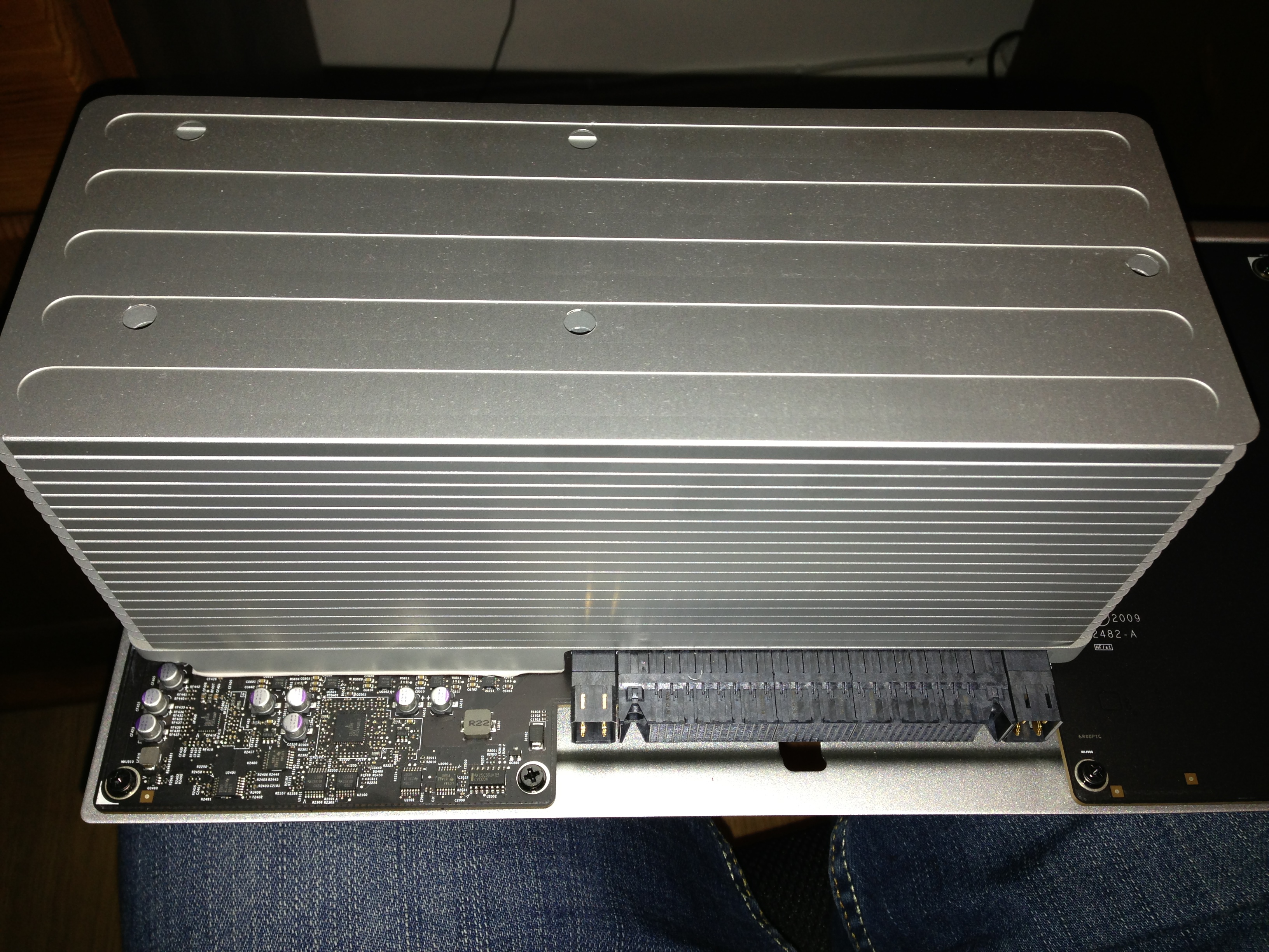

I've just noticed my 2012 Mac Pro has a bead of white silicon along the edge of the heat sink. Correct me if i'm wrong - I'm thinking Apple has added this as a tamper indicator. Alternatively, could possibly be to stop arcing of components and heat sink in that area?
Has anybody seen this before? Is it on 2010 models? Anyone with a 2012 have similar sealing of the heat sink?
Nanofrog - It was said in a previous thread of mine that the retention mechanism on the 2009 board is different to that of a 2010/2012 board Lidless V Heat spreaders. My board (most definitely from a 2012 machine), has a marking '2009' on the right side of the image. Any significance?
Only the 2009 DUAL CPU board has a different retention mechanism then the 2010 and 2012 DUAL CPU board.
I dont know if the 2009 means that it is a board from 2009, but its very likely. Wouldn't matter though because the boards fro 2009 and 2010/12 only differ in terms of firmware. Apple could have updated the firmware on left over 2009 boards to use in newer machines.
You definitely have a CPU with integrated heatspreader since its a single CPU board. So upgraded to a more powerful CPU is very easy.
No that's just a thermal pad. It's taped [using thermal tape] to the heatsink, but not to daughter board. It's also there so those chips on the daugherboard do not short out when it's touched by the aluminium heatsink.
You're a star, thank you.
