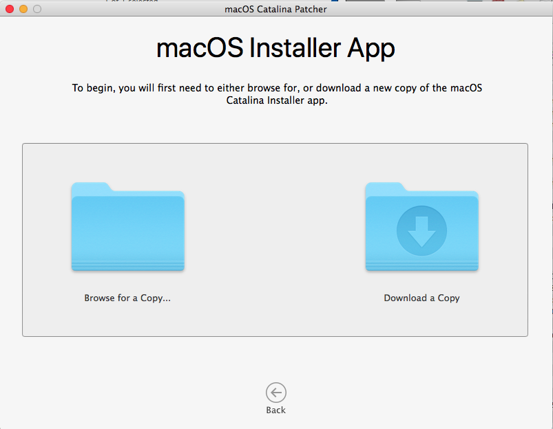

Most important: you will need a thumb drive for this method — ideally at least 16GB, but you might be able to get by with 8GB.
I went through, step-by-step, in a somewhat similar situation with another person earlier this week who was trying to install High Sierra on their iMac the traditional, Apple Store/recovery method, and was having trouble.
The method I outlined to them is exactly the same for you, except you’re going to want to grab the dosdude1 Catalina patcher from his web site.
Upon opening the Catalina patcher utility, the installer wizard will let you download a copy from Apple directly:
In the method linked above (and, I believe, covered as well on dosdude1’s embedded tutorial video on his Catalina page), the utility helps you to put the downloaded Catalina installer onto the thumb drive you plan to use — setting it up so that your Mac can boot from it. There won’t be anything for you to need to patch, as Catalina needs none for the MacBookPro9,x series (which you already know). There is one thing you should de-select: de-select Options > Auto-apply Post Install Patches, as no patching is needed for your system.
As @rovostrov noted, your new SSD will need to have an APFS partition on which you plan to install Catalina, as Apple dropped the ability to install macOS on HFS+ starting with Catalina (it was still possible to do so with High Sierra and Mojave, to the benefit of anyone still using an HDD spinner).
This ought to get you to where you need to be without having to deal with the Apple Store throwing errors into the mix.

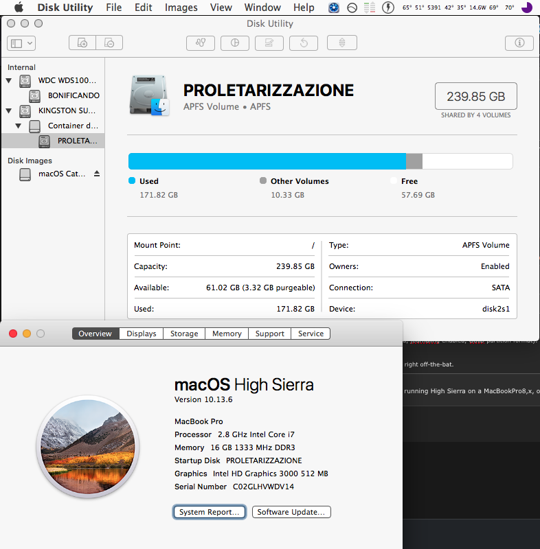

@Fishrrman — this is incorrect.
As we speak, I’m running High Sierra on a MacBookPro8,x (late 2011) on an APFS partition, because for SSDs, High Sierra and later need APFS.
@volkwagen1300 — for High Sierra, Mojave, Catalina, and everything later, you need to use an APFS partition scheme if installing on an SSD. Apologies for any confusion laid out by Fishrr.

I recommended the use of disdude1’s Catalina patcher utility to prepare the thumb drive for bootability. The utility relies on, as memory serves, the createinstallmedia command on the back-end.
When you have the installer-file downloaded to your Applications folder just format a thumbdrive and then rename it to MyVolume and copy-paste the correct command from Apples site to the terminal. Then sit and wait for few minutes and follow instructions on screen if needed (enter your password, enter Y etc). IMO could not be much easier.

Once HS was running OK I downloaded the dosdude Catalina patcher as was suggested above (did it on my other Mac) - it downloaded OK and I followed its instructions and made a bootable USB thumb drive (different one). Repeated procedure of holding down option key on laptop, eventually wound up at the gray screen and chose "reinstall MacOS", selected drive with the Catalina installer - installed on second try (got an error on first try).
