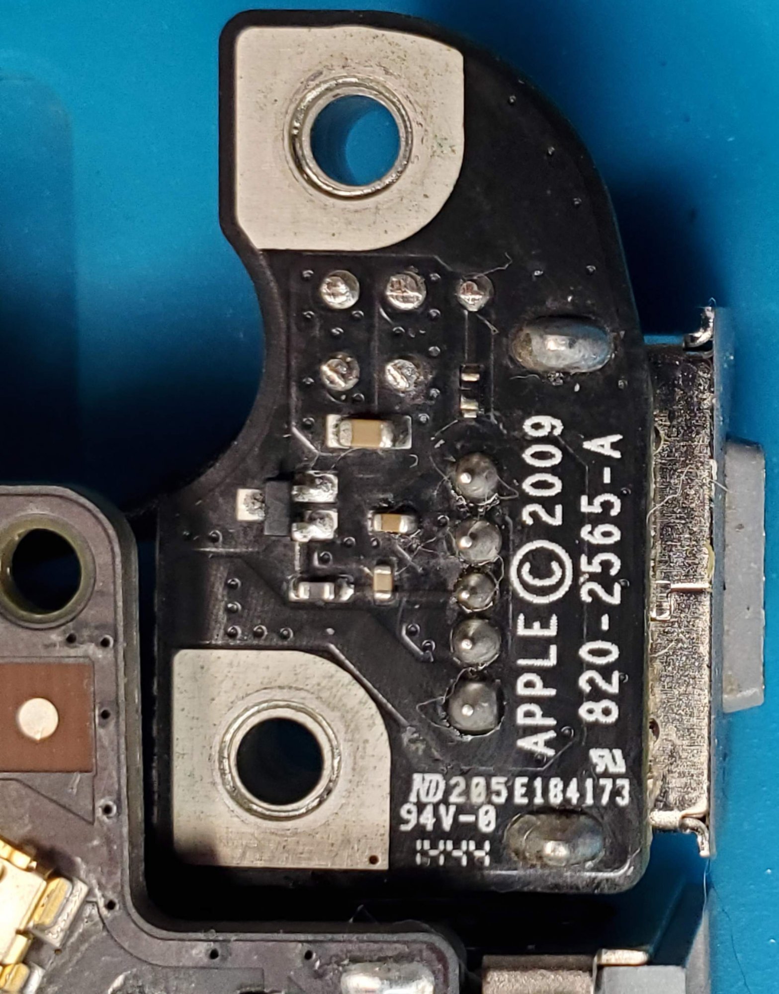

Today I decided to pull out the system board and it looks to be in fairly good condition. I am struggling with the decision to purchase a DC-In-Board or just run it through the ultrasonic cleaner (unless someone has a reason why I should not do so).
Disassembly wasn't really that difficult but I'd rather not go through it again so for a few bucks I should just replace the DC-In-Board.
EDIT: Here's a pic of the DC-In-Board removed from the system:
Reactions: bobesch

UPDATE: I've got the DC-In-Board and System Board in the ultrasonic cleaner now. It'll be done in a few minutes and the next step is to dry it off.
Question: Should I reassemble and try it out? Or wait for the new DC-In-Board to arrive (about a week from now)? I don't mind waiting but I'd be curious to see if the ultrasonic cleaning solves the problem. Only way to know for sure is to reassemble with the current parts.
But then, while not a pain to disassemble, it's not as simple as replacing the RAM.
Any recommendations? Assemble now and test or wait for the new part?

I went ahead and decided to do a partial reassembly as you suggested. A few things I tried:
  • Plugged the DC-In-Board into the power supply to see if the light illuminated. It did not but I have no idea if it would without being connected to the system board.
  • Connected the DC-In-Board to the system board and then performed the same test as above with the same results.
  • Inserted the system board and DC-In-Board back into the chassis and reconnected most of the cables. A few, such as the speaker and microphone, were left disconnected as I did not feel they would affect the test. I can't say that I connected all the necessary connectors as I didn't do it methodically. Same results as the first two tests.
At this point I decided to wait for the new DC-In-Board to arrive (supposed to be here in a couple of days). Does anyone know if the power adapter light will illuminate under either the first or second bulleted tests I performed?

I believe it occurs with the conditions described in the second bullet point: the DC-in board needs to communicate with the logic board for the latter to return to the former the signal needed for displaying a status light on the magsafe adapter.
Although I’m not 100 per cent positive here, that inter-board communication has to happen, since the logic board, not the DC-in board, has a direct connection to the battery (and thus can report to the DC-in board whether or not a battery is detected in its system). Power management itself occurs on the logic board because the logic board needs to know how to clock the system when powered on (for MBs/MBPs/MBAs, this power management system down-clocks the CPU by at least half whenever a battery is not present or when the battery is unable to deliver the current needed to power the system on its own — i.e., a dying/dead battery).
This may be (I’m guessing here) why it takes a moment between when the magsafe adapter makes contact with the DC-in board and when the adapter displays a green (or green, followed by amber) indicator: the power management IC is checking for battery presence/battery health/charge status, before directing the DC-in board on what it should do and what it should display on the adapter.
What you’re doing — trying a different DC-in board — is what I would try first, along with trying a different magsafe adapter (in the unlikely case it itself has a fault somewhere), before moving on to the health of the logic board itself.
A little more context: the actual MagSafe connector has a simple 1-wire switch chip that runs the LEDs based on commands sent from the motherboard through the DC-In board; the only other data drawn from the MagSafe connector is a 64-bit ID that identifies the charger and gives values like the charger’s max wattage.
A genuine MagSafe adapter will only step up to its full power after the target (i.e. the MacBook) notices it and applies a resistive load. Then the target will read the ID, start charging, and turn the appropriate light on in the connector.
So you do indeed want to have the motherboard connected to the DC-in board and the battery in order for the connector to light up.
(You can even see at the end of that post that he is using a DC-in board as a MagSafe breakout.)
The DC-in board is often the first casualty of water damage on a MacBook, so hopefully it’s the only one at fault here.
