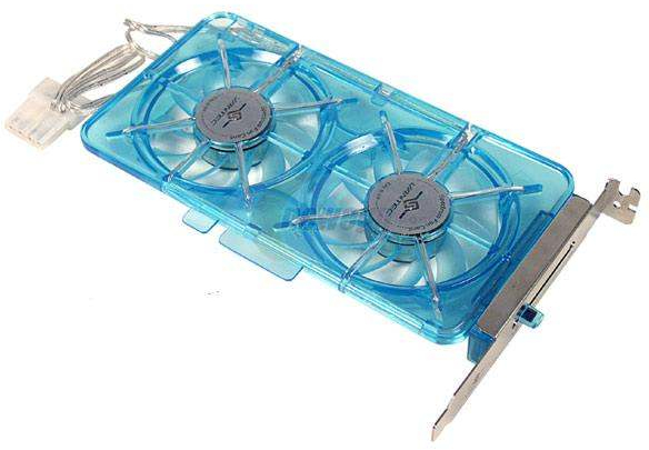

Here is the PDF file concerning the overheating problems:
ATTO will not use built-in fans on the controller cards...
As mentioned in the pdf, I use a pcie fan to blow directly on my R644
Zero heating issues!
But then again it's not used as a server. On 12hrs max
