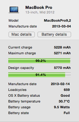

Battery status in the menu bar is "Normal."
Coconut battery gave the all clear as well. Screen Shot 2014-11-29 at 9.35.55 AM.png
