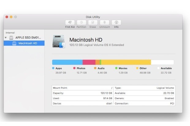

There's a bunch of questions here. It would be helpful even if you answer no to one of the first questions and can't proceed through the remaining questions.
So when you run Disk Utility, does this screen appear?
If so, does your SSD appear (is that what you mean by "it detects the SSD")? The SSD name would appear where "APPLE SSD SM01..." appears above.
If so, does a partition appear? This is "Macintosh HD" is in the screen above.
If so, does the name appear in black or a light gray? (You may need to move the blue highlight by clicking on the disk name to be sure.)
Are you able to select the partition name? If so, does Disk Utility allow you to press the "Info" button? Make sure the partition name ("Macintosh HD" in the above screen) is selected when you do this.
If you're able to press the Info button, another screen will appear with text info. About the 8th line down is one that says "Writeable" on the left - what does it say on the right?

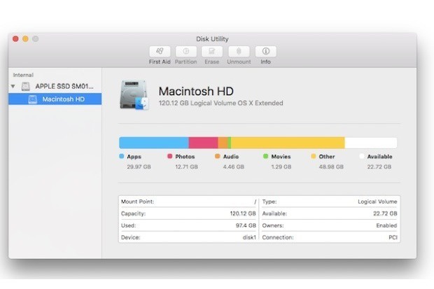

Disk utlity does show; now the screen I have differs from what you're showing but it is clearly the disk utility.It shows both the SSD and the "Mac OSX Base System". When I click on info for the base system it says no next to writeable
So if the "Mac OSX Base System" is the indented entry which is under whatever your SSD name is (not indented), then your SSD has gone into read-only mode. You can check with the SSD manufacturer if there is a way to revive the SSD but going into read-only mode usually means the drive can no longer be used (you may be able to retrieve data from the drive). You can also search the web for "ssd read only mode" for more information.

OK - so going back to my list of questions - does your partition name ("Mac OSX Base System") appear in black (your SSD name should appear in black) or in a light-gray color?
If you select either the SSD name or "Mac OSX Base System", can you press either the "First Aid" or the "Erase" button?
If you select either the SSD name or "Mac OSX Base System", can you press either the "First Aid" or the "Erase" button?[/QUOTE
With the SSD I can press "erase" but not "first aid" and with the "base system" I cannot erase;with " first aid" for the "base system" I can click on " verify disk" but not " verify disk permissions" . As an aside I have the new SSD in the enclosure I can click on "erase" and under "first aid" and can click on "verify disk" but not "verify disk permissions".
