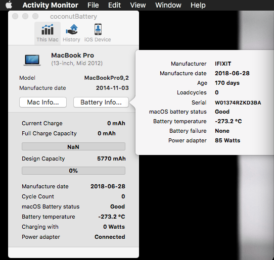

I'm having the same problem.
2nd iFixit battery in a month with sudden sleeps or shutdowns, sometimes no battery status menu until a SMC reset, and no change in the load cycle count after a week of trying.
This was one of the results of the first battery:
It's bizarre.
I've wiped the computer, reinstalled the OS (Mojave 10.4.2), and had a suspect hard drive cable replaced.
Also had an Apple service provider run some diagnostics; but they found nothing else.
Only other things I can think of, are replacing the MagSafe DC-In Board or maybe it's corrupt firmware.
I got a reply back from iFixit a day later asking for reason for original battery replacement, macOS version, and symptoms (such as what happens when I unplug the power cord).
I responded that same day and haven't heard back from anyone since.
In the meantime, I had reset the SMC but kept the iFixit battery in; if it happens again, then I'm through and will ask for a replacement or refund.

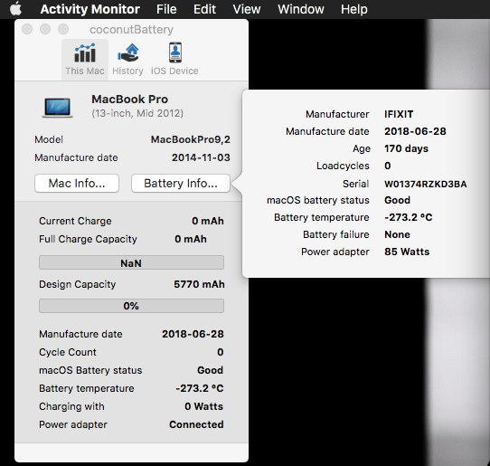

It's bizarre.
-273 degree Celsius?! 0 Load cycles? Current and full charge 0! What is going on?
