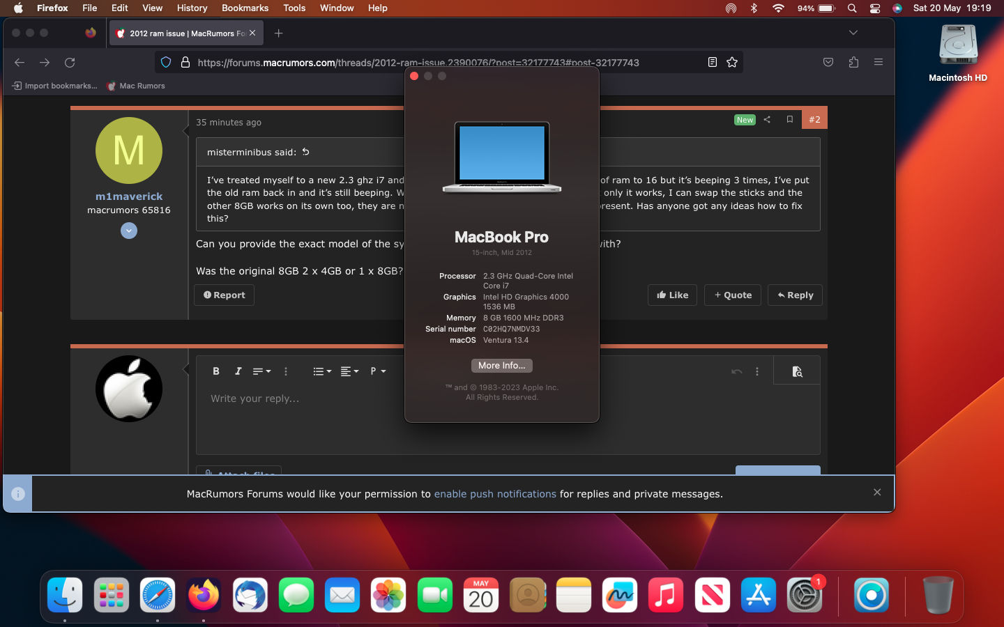

I’ve treated myself to a new 2.3 ghz i7 and I’ve fitted an ssd and upgraded from 8GB of ram to 16 but it’s beeping 3 times, I’ve put the old ram back in and it’s still beeping. When I use one 8GB stick in the bottom Port only it works, I can swap the sticks and the other 8GB works on its own too, they are new crucial sticks so it’s only using 8GB at present. Has anyone got any ideas how to fix this?
Can you provide the exact model of the system you're experiencing the problem with?
Was the original 8GB 2 x 4GB or 1 x 8GB?

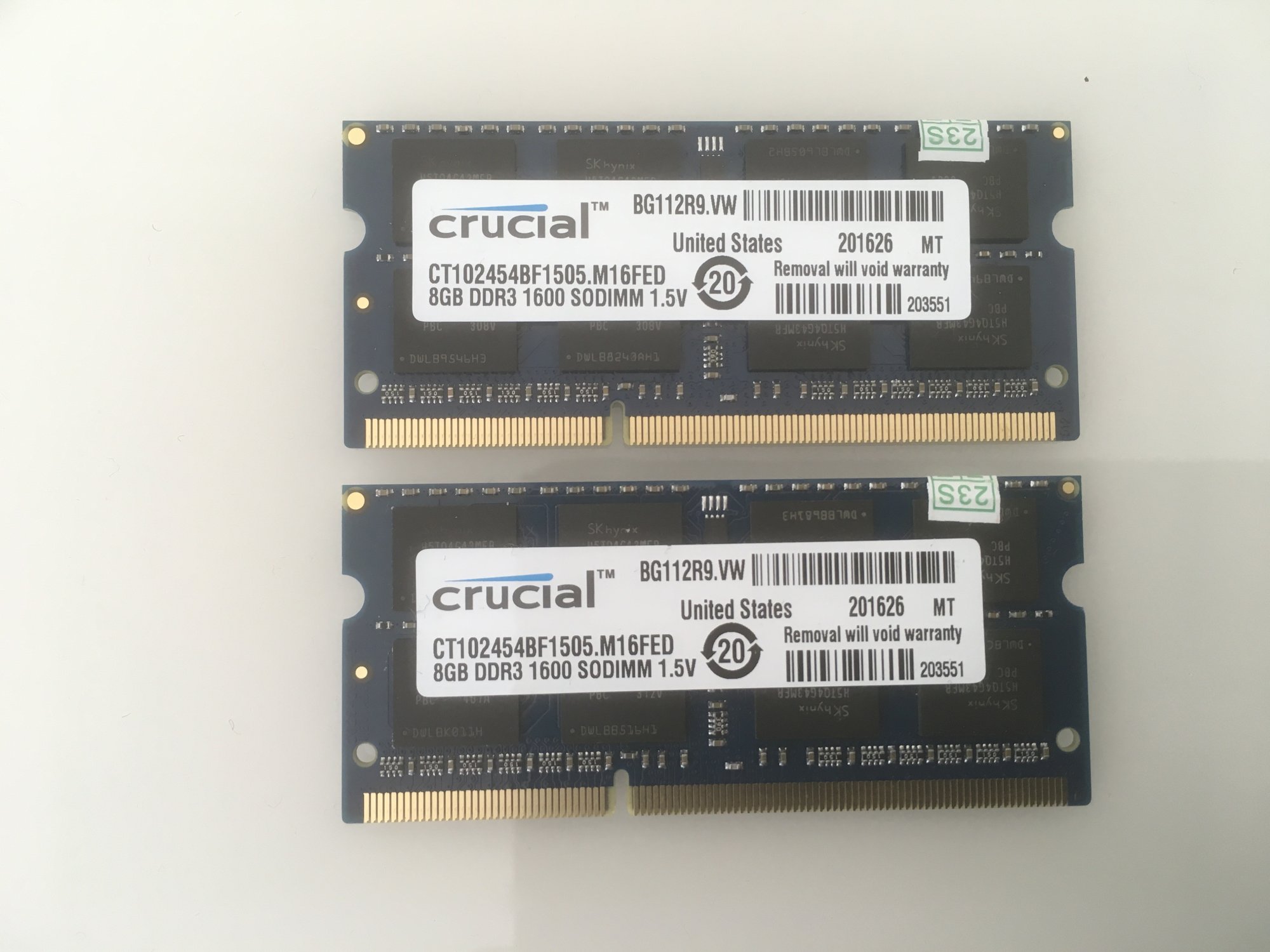

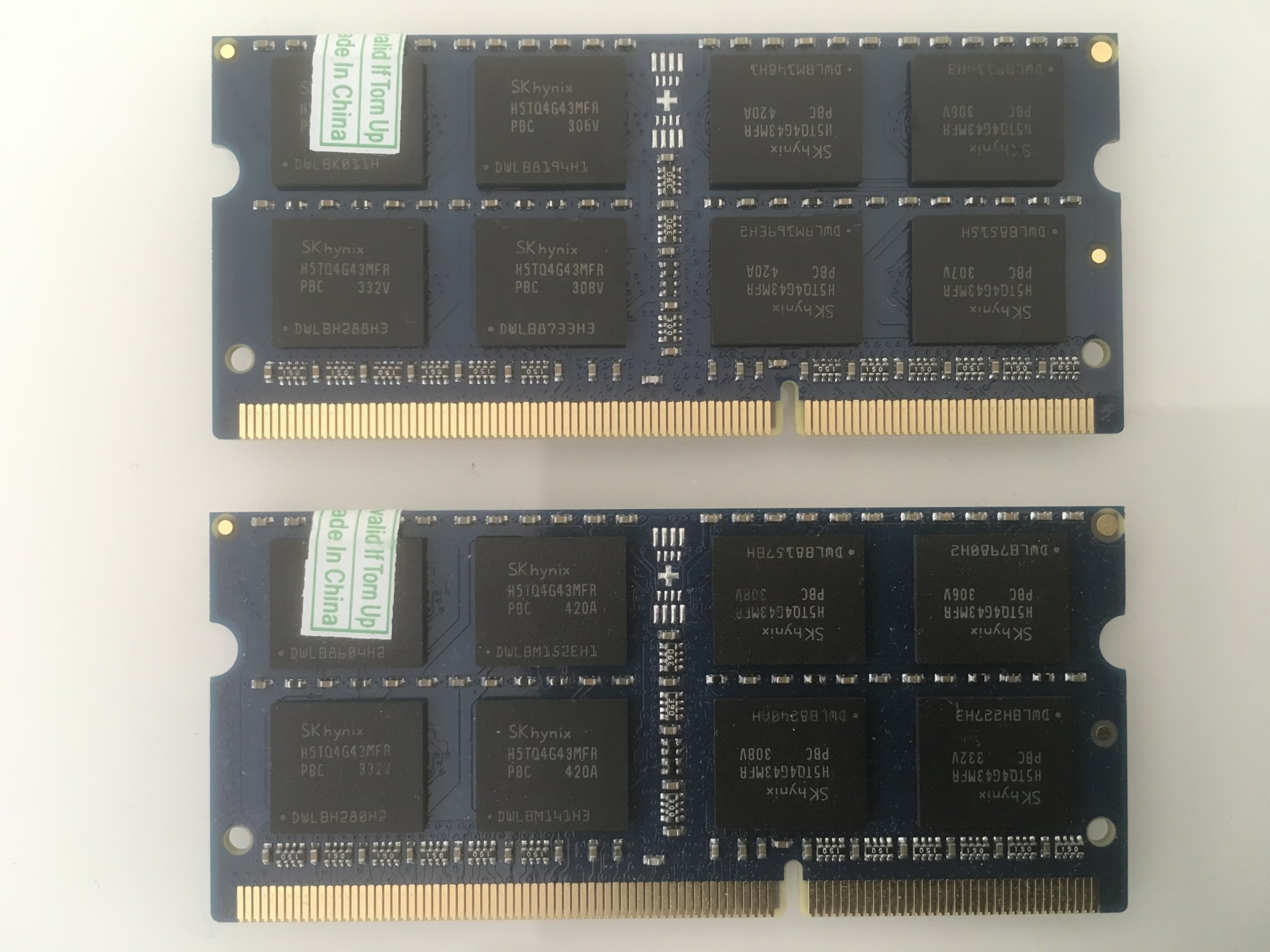

Both of your RAM sticks are identical?
Can you post a side-by-side photo of them here?
At this time, the only issue we can think of, is different RAM type. (Bus speed or Voltage, or even ECC ram. Some DDR3 SODIMM also have ECC chip, according to a post I read recently)
I'd just get a second stick like you already bought and keep the other as a spare. I'm sure it's down to the memory density.
I never had problems with Crucial RAM - you can find it for cheap at amazon.
Yes they were bought together

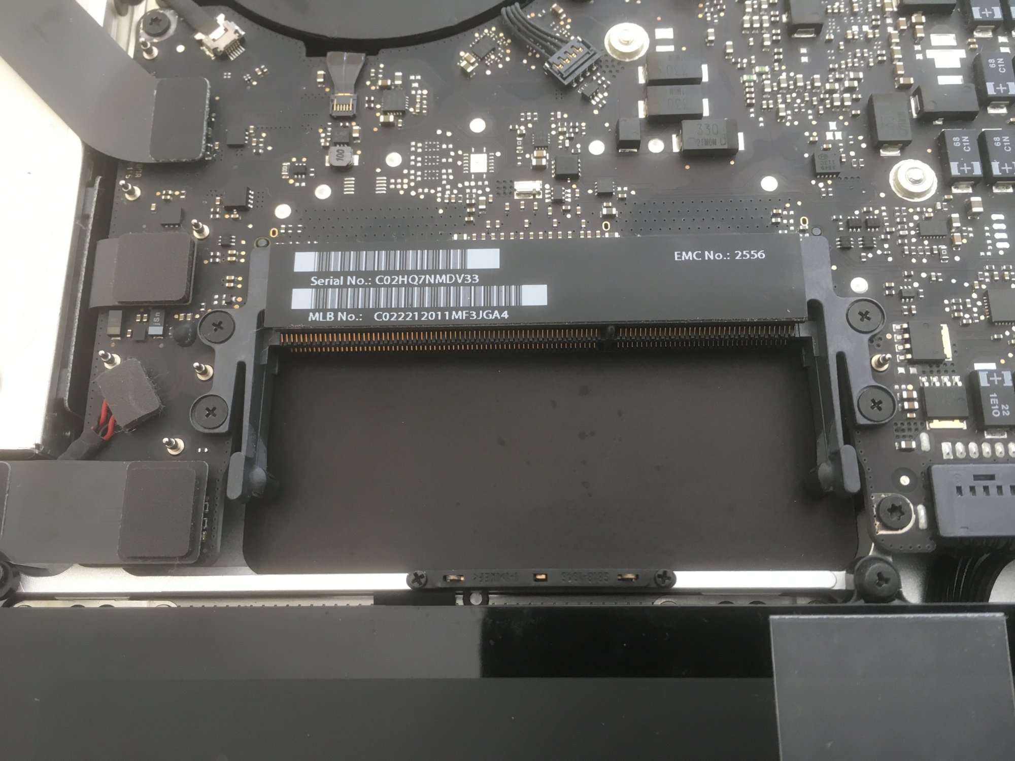

That all said, have you A) been able to run a low-level memtest on each of the RAM sticks, to verify they check out okay, and B) have you been able to given the top RAM slot a close visual inspection (to make sure there isn’t some minor debris obstructing one of the connection points which found its way there as you were pulling out your original RAM)?
SIGNIFICANT UPDATE: The pics of the two sticks of Crucial RAM you shared above are DDR3. Look at your OEM RAM sticks. Check whether they’re DDR3 or DDR3L. This is relevant if the system expects DDR3L (which runs at 1.35V) but the RAM only operates at 1.50V. Whereas throwing in DDR3L RAM into a system which came out when all RAM ran at 1.50V will work find (as the DDR3L logic will step up to 1.50V), a system designed for DDR3L (1.35V) RAM is not designed to accept RAM which only runs at 1.50V (i.e., DDR3). It does surprise me that one stick works, but I have a sneaking suspicion that the original RAM from your MBP was/is DDR3L. If this is the case, you will need to probably return these in exchange for DDR3L, which may or may not be the same price.
