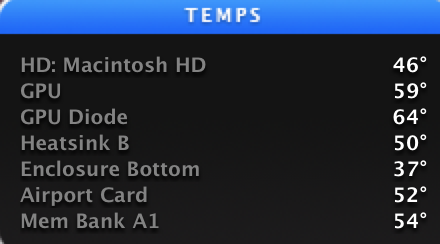

My 2012 Retina macbook pro is having some heat issues and I was wondering if it's something I can fix by replacing the battery.
The battery is showing that it needs to be serviced and although the computer is quite old now, it really shouldn't be having so much heat while just running Chrome and a few other apps.
What do you guys think? will replacing the battery solve the issue? or is it something that requires replacing the computer?
Unlikely, but you're going to have to elaborate on "heat issues." What are the temperature sensors reporting? It probably isn't an issue if the computer is operating, in any case.
However, if the battery needs to be serviced then it should probably be replaced anyway unless you're fine with using the computer as a desktop.

I've screen-capped the temperature sensors report below.
Fan is running around 2200 RPM.

I had my rMBP 2012 running like yours. 4 days ago I opened it and was full of dust. I cleaned everything and replaced the termal paste and now it runs much cooler.

Those temps are quite cool, actually. Nothing at all to worry about. Your battery health has nothing whatsoever to do with operating temperatures.
Unless your CPU is reaching 105C (or more), you have nothing to fear.
ah very nice. i guess it's from the dust.
will they remove the dust when i replace the battery at the apple store?
