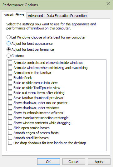

You can try to disable visual effects in Windows, to see if that helps.
  1. Right-click on the start menu,
  2. Click on "System"
  3. Click the "Advanced" tab.
  4. Click on "Settings" button under the Performance section.
  5. Click on the radio button for "Adjust for best performance".
  6. Click OK.
  7. Click OK.

Also, what will happen if I disable visual effects? What will change in terms of my use and what I see on the screen
Yes, that's correct. If you follow the instructions it will update the drivers. It will not wipe your Windows install.
The visual effects changes will just turn off things like what's shown in the attached pic.
You can pick and choose which ones you want to leave on. Just experiment with them to find what works best for you. It's all purely cosmetic, and won't have any affect on any applications that you use.
