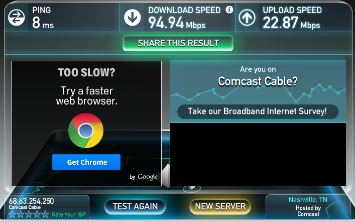

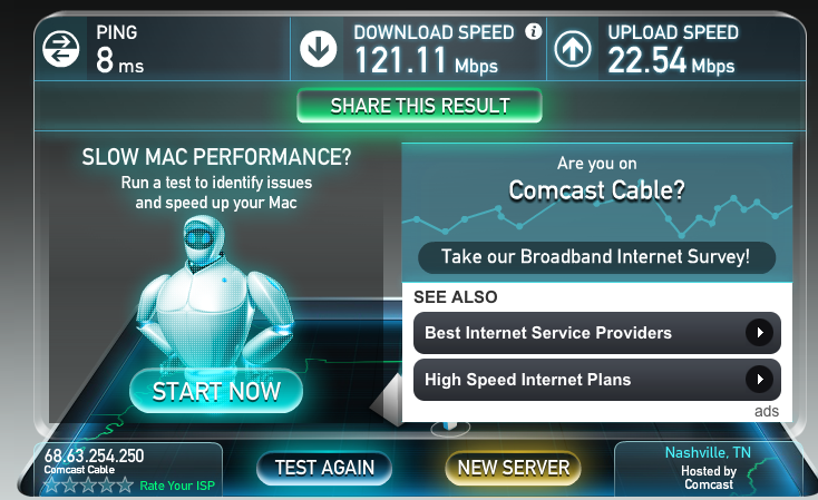

I also formerly thought so. However attached are Speedtest.net results from my 2013 iMac 27 using 802.11AC wireless (121 mbps) vs my wife's 2012 iMac 27 using wired 100Base-T ethernet (95 mbps) to the same Asus RT-AC66R router. This test was repeated multiple times with the same results. The ISP is Comcast Xfinity 105.

So far, no. My 2013 iMac is within 10 feet of the Asus RT-AC66R router, so that probably helps.
At the other end of my house, my wife's 2012 iMac with 100Base-T wired ethernet gets better performance than wireless, about 92 mbps wired vs about 60 mbps wireless. However her iMac doesn't have 802.11ac, only 802.11n, so maybe the newer wireless protocol would be better.
So what you said is still often correct. Wired is more reliable over more situations than wireless. However wireless is continuously getting better, and in some cases it's better than wired.
