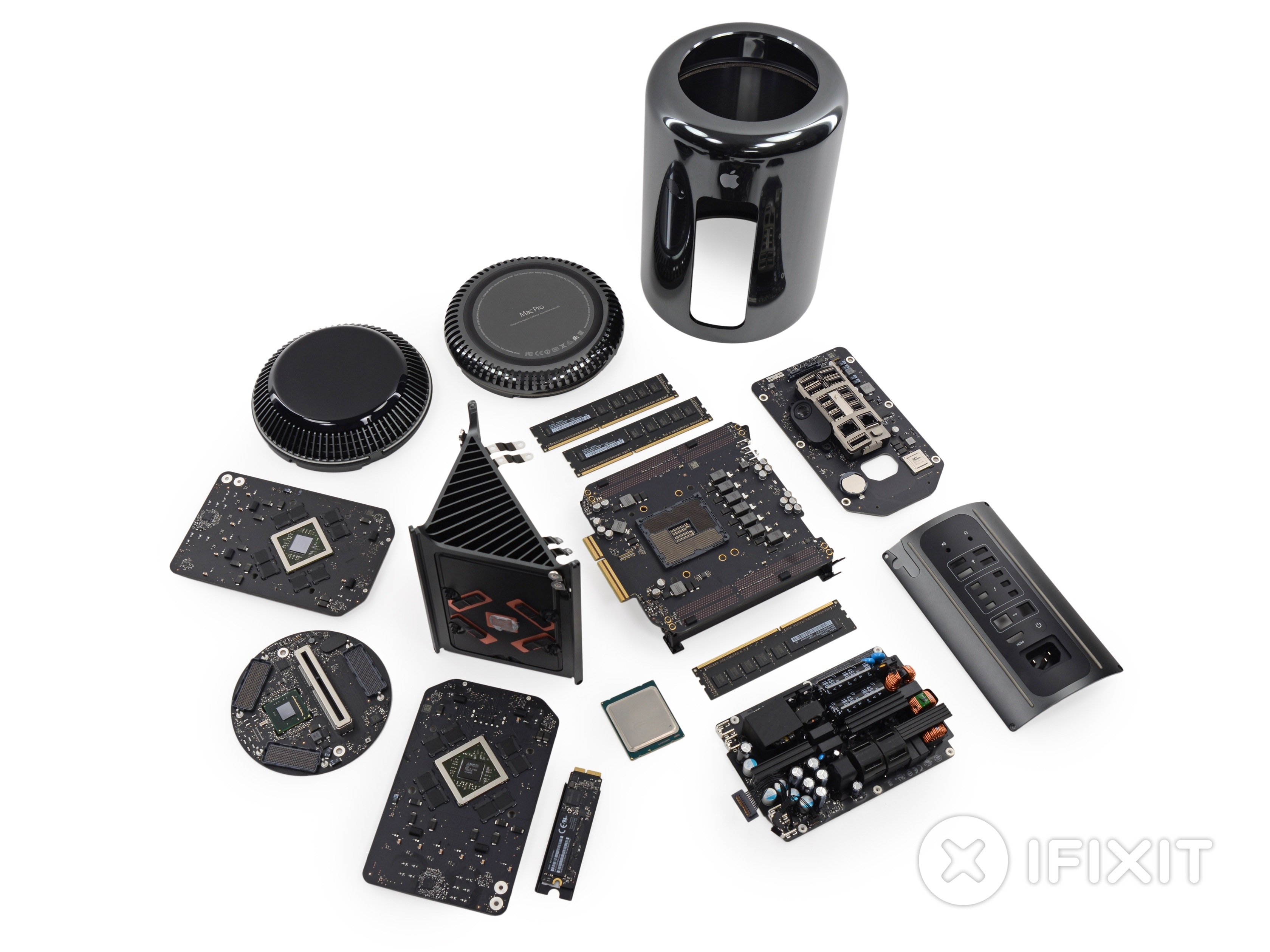

Check if the AirPort Extreme cable is fully connected, inspect both sides of the flat cable. If the cable is not connected absolutely perfectly, the Mac Pro slows to a crawl.
iFixit teardown step number 8:
This is the iFixit repair guide for the AirPort:

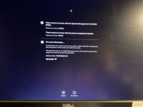

In addition I ran Apple Diagnostics and got this from it, any ideas from here? Everything I read online seems to indicate that it’s one of the cables that’s not quite seated perfectly, so I’m going to do a complete tear down and rebuild once again to double check every connection.

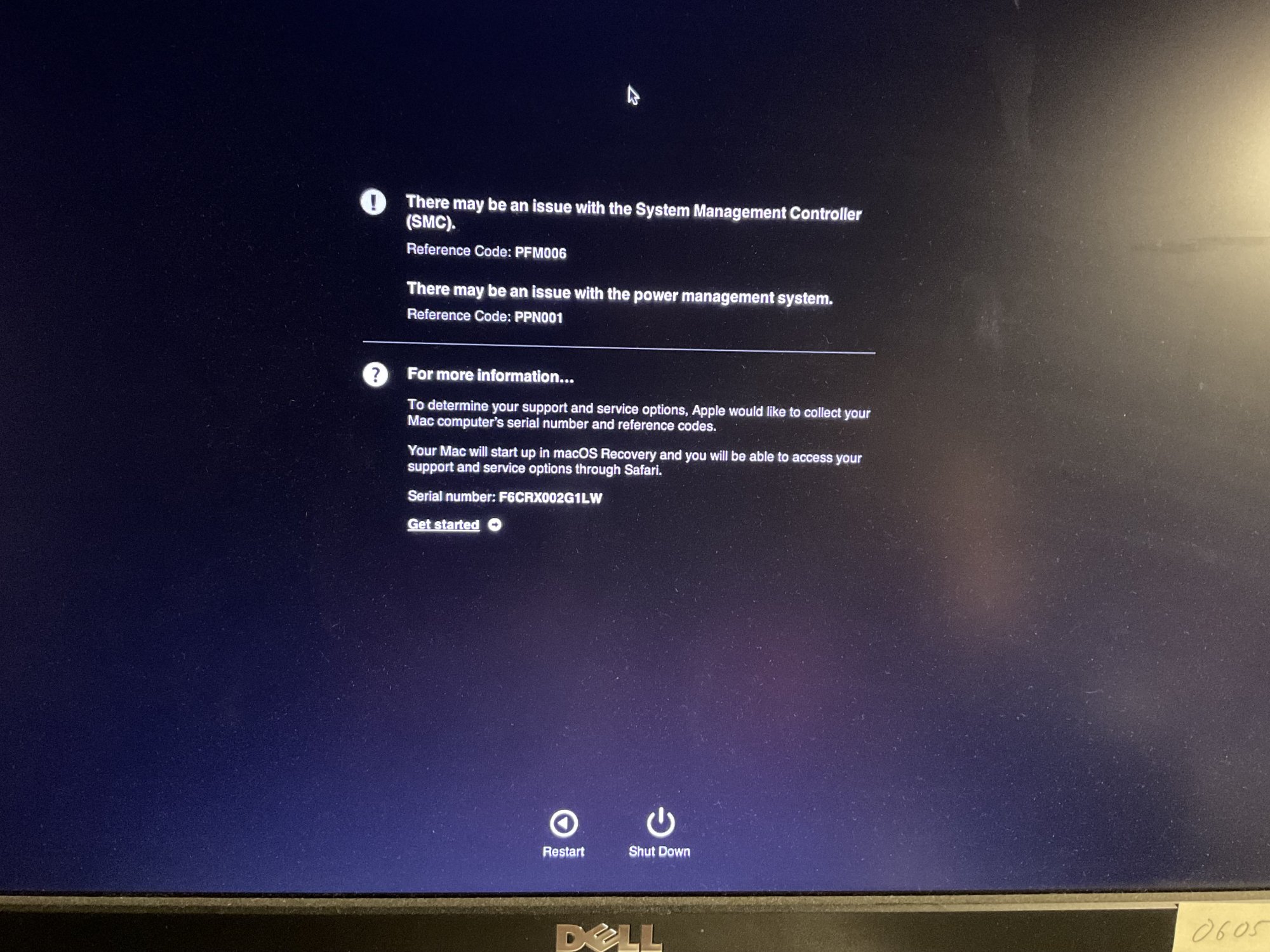

Thank you, I found that post on iFixit while googling and reseated the cable. I just finished with my rebuild, same symptoms. Running diagnostics again to see if the errors are any different or not.
