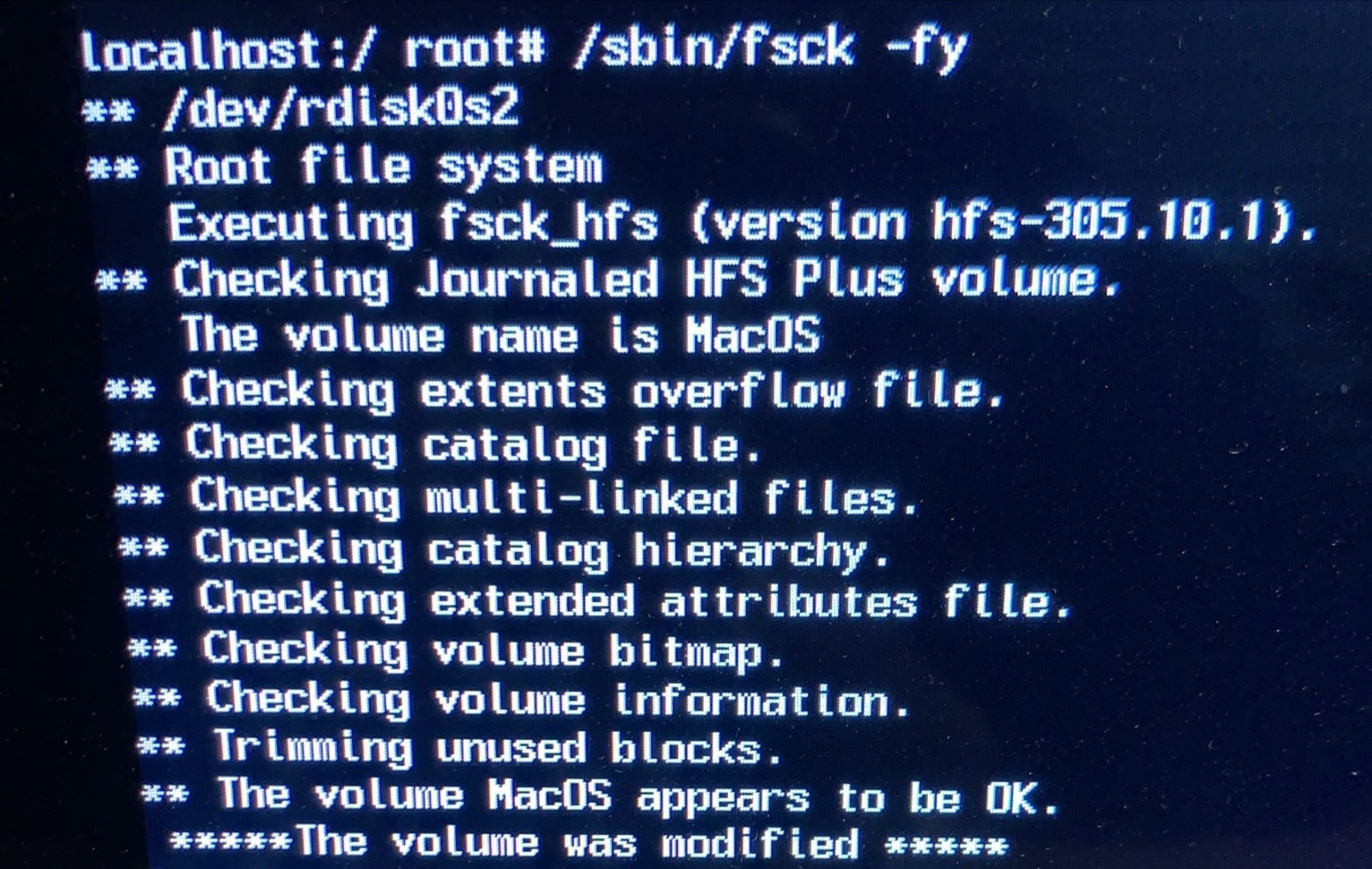

I have also tried single user mode (Command-S) and it boots up to a lot of text on the screen and a command prompt. What am I suppose to do now that I am here? Is there a command I need to run or something that I can get it working again? Thanks

You probably (somehow) need to test the SSD.
I think your first chance is Single User mode.
When the text scrolls down, and you get the command prompt - a couple of lines up are your possible next steps.
Run the fsck command
type
Code:
/sbin/fsck -fy
then press enter to run that command. Should show a few results, testing the drive directory.
If you get a result with errors, that may simply be showing you that the drive is failing.
If the command runs, no errors, and reports no problems, then run the mount command
Code:
/sbin/mount -uw /
(there's a space between mount and -uw, and another space between the -uw and the final / )

I ran the file system check command above and got the following output. I don't see any errors.
I also ran the mount command right afterwards and it worked fine with no errors. It didn't print anything though, but I don't think it was suppose to.
