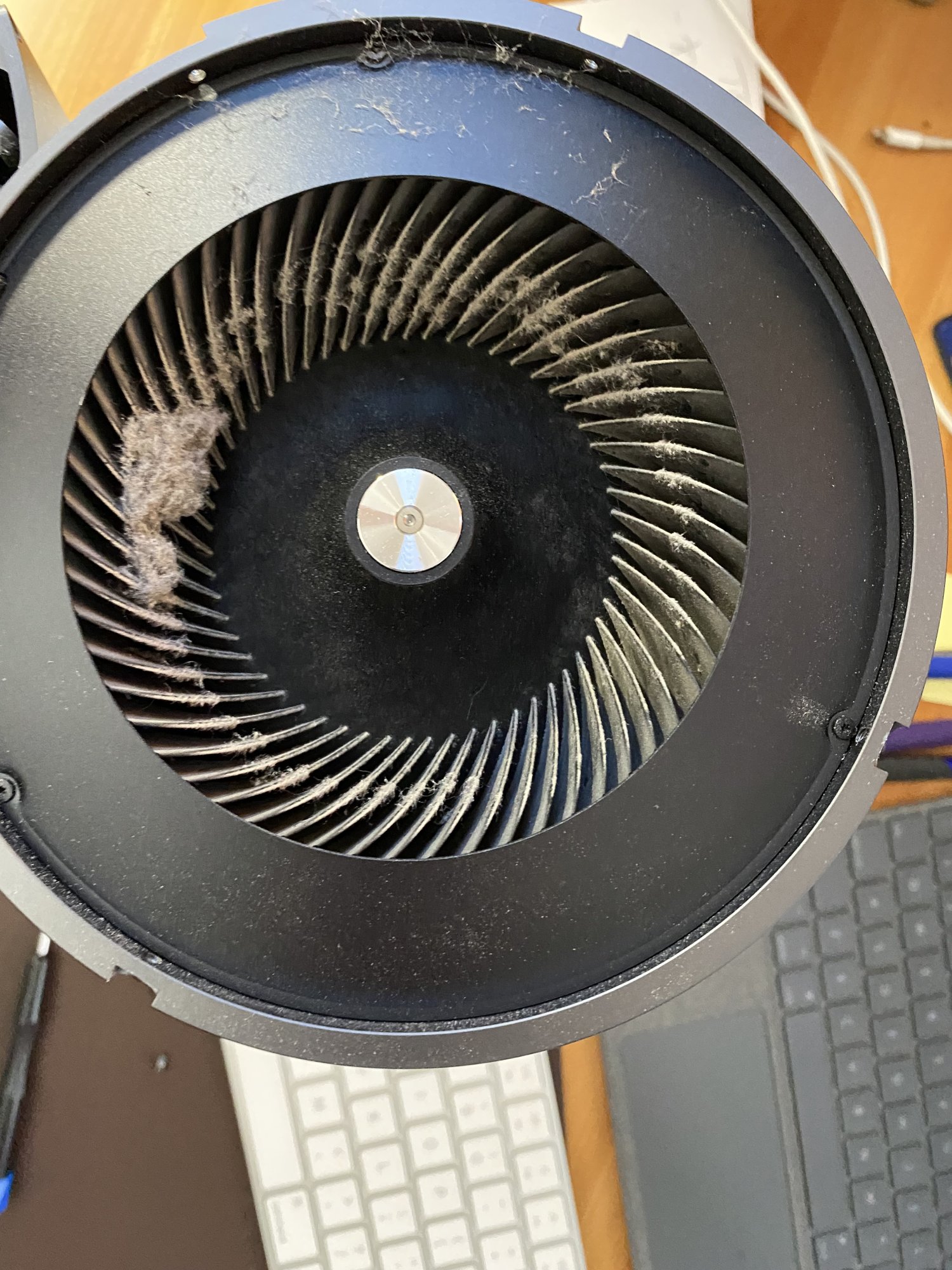

I resolved the heat issue - pulled the top and bottom off, and vacuumed the insides and the fan. Now running 64 C versus 90 C. Ha!
Woah - 90C! Big drop to 64C. 🙂

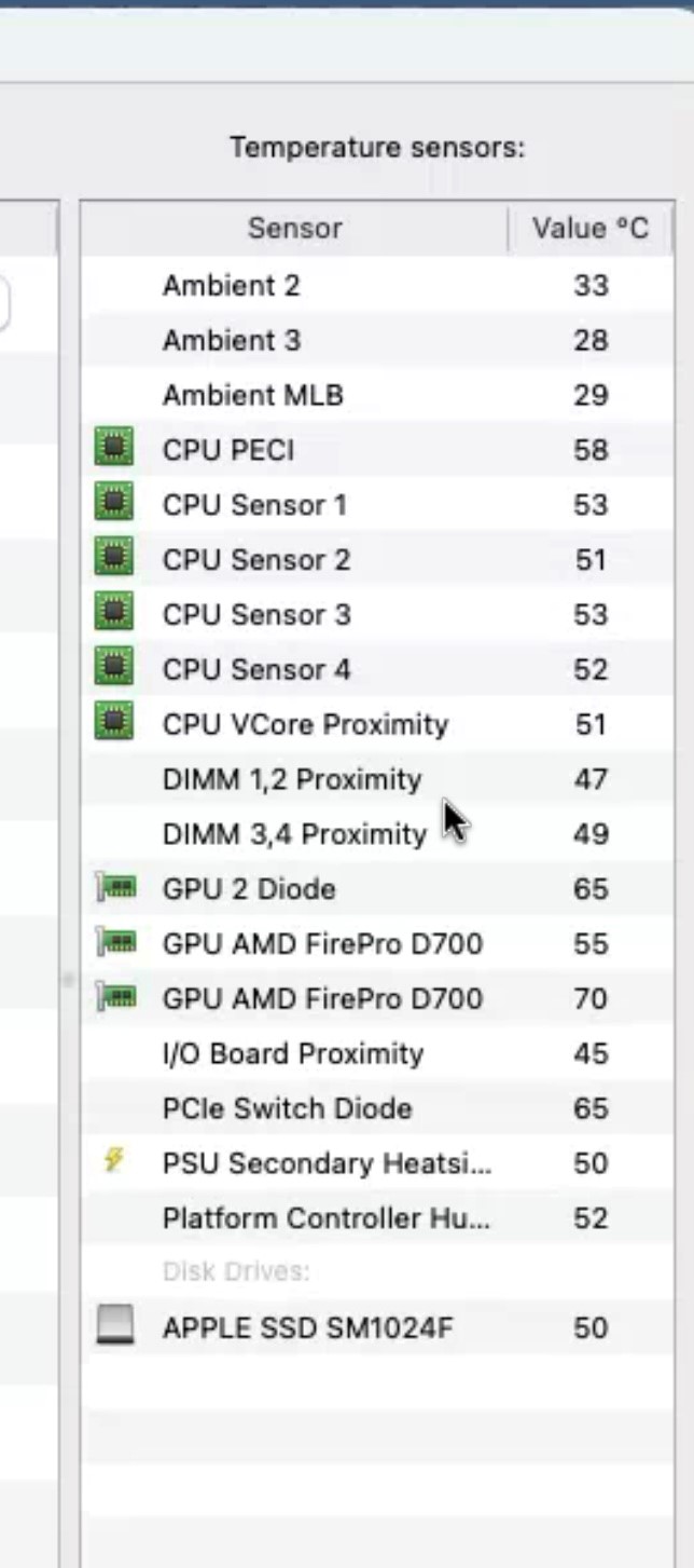

Hi everyonetemp.jpg, I have a question regarding the temperature of the GPU’s on the 2013 Mac Pro. I have 12 core with 128gb of Ram. I was recently given D700 chips by a colleague. I upgraded my mac from the d500 and I noticed that even while idle, one of the d700 chips hovers around 65-70 C. The other is usually 55. Is this common for these cards or might they be defective?

Hi everyoneView attachment 2018614, I have a question regarding the temperature of the GPU’s on the 2013 Mac Pro. I have 12 core with 128gb of Ram. I was recently given D700 chips by a colleague. I upgraded my mac from the d500 and I noticed that even while idle, one of the d700 chips hovers around 65-70 C. The other is usually 55. Is this common for these cards or might they be defective?

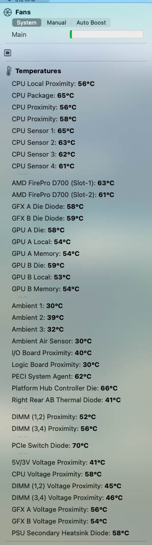

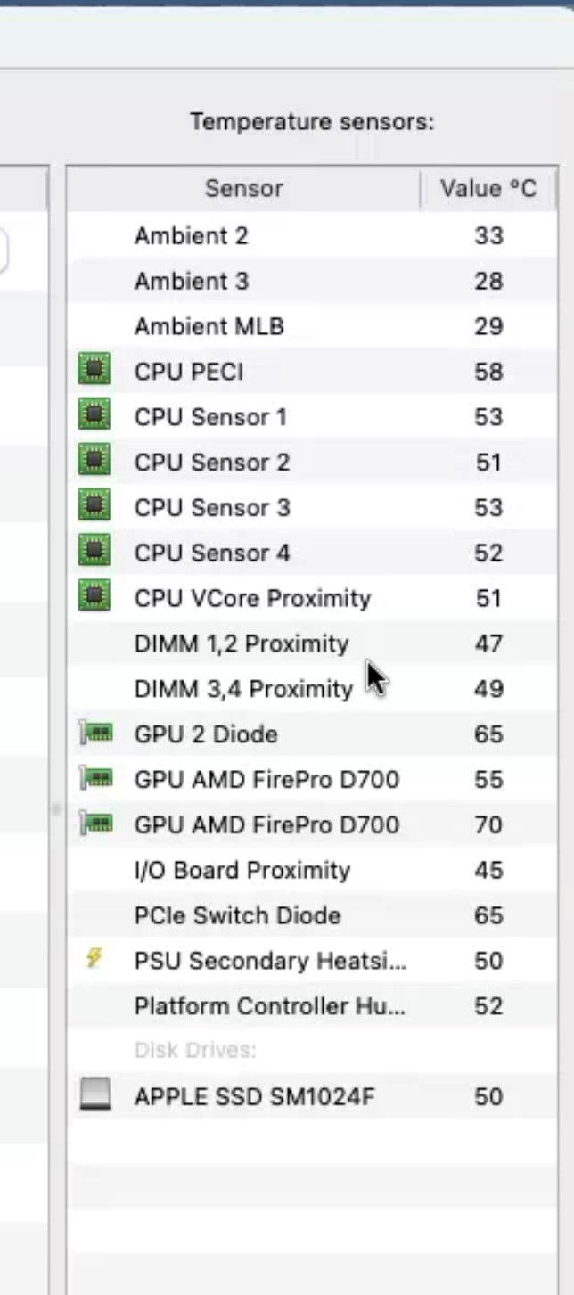

See my attached screenshot for my 2013 6,1 with 6-core Xeon and D700 GPUs with 64GB memory. I placed a small fan under the device which is providing more cool air and has it running a few degrees cooler. My GPUs are at 63-61 C at idle.
Ok, thank you, so I'm going guess that the D700's just naturally run hotter? What fan did you place under it? I was looking at a 140mm fan on Amazon.

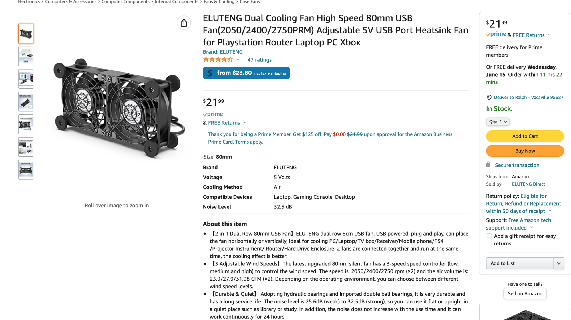

I used this one from Amazon and placed the 6,1 right on top in the middle, so that the fans are pushing up fresh cool air into the device. As a side, my grandkids loaned me 4 square Leggo blocks to raise the fans off the desk for better circulation. Seems to work great now.
