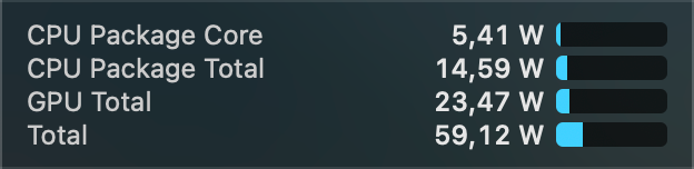

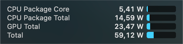

My 12-core D300 uses 75W in idle with a 5K display; iStat menus reports 59W.
My 12-core D500 uses 68W in idle with one 2K display; iStat menus reports 58W.
My 12-core D500 uses 94W in idle with two 2K displays (so +26W for a 2nd monitor 😱).
In sleep they use ~2W.
I‘d always login so you can see in Activity Monitor (or iStat menus) if the CPU and GPU are actually idle.
iStat menus also shows the (estimated) power consumption for CPU, GPU and total to give you an idea of the main electrical load.
Perform a SMC and PRAM reset, then check again.
Does the Mac heat up during sleep? If not, something is definitely wrong with your wattage meter.
BTW, the 12-core has a better performance-per-watt and runs cooler in idle (and I guess draws less power) than the 6-cores I had previously installed.
EDIT: updated values (Big Sur 11.7.1). The screenshot in iStat menus shows 59W but the Mac actually draws 75W.
EDIT2: updated values for D500 machine
