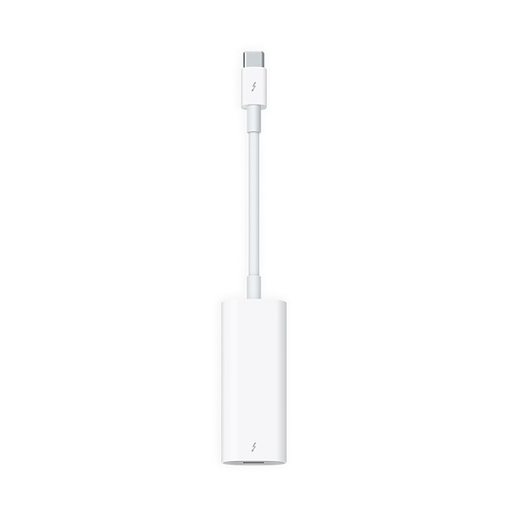

There is this adapter , but Apple won't officially recommended its use with the Mac Pro 6,1 .
Thunderbolt 3 (USB-C) to Thunderbolt 2 Adapter

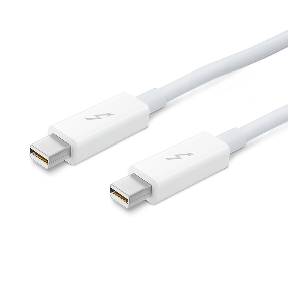

And here is Apple's half meter long TB2 extension cable , male to male connector :
But there are some user reports of success with attaching TB3 devices to the TB2 ports on the MP6,1 with this cable .
You also need another adapter cable ( male TB2 to male TB2 ) to use it .
It's connected like this :
Mac Pro 6,1 ( 2013 ) TB2 female port > TB2 male connector extension cable ( one end )----TB2 male connector extension cable ( other end ) > Apple TB2 female connector adapter cable ------ Apple TB3 male connector adapter cable > Your TB3 device's female port .
It should work if the adapter supports data going from TB3 to a TB2 computer, and as far as I can tell, that adapter is one of the only few that actually properly does that (usually the other adapters only support attaching TB2 devices to a TB3 computer)
I doubt Apple would recommend it, but probably only because they'd prefer to convince you to spend money on newer TB3 Macs
It is a bi-directional cable , but I worry when Apple doesn't give something the official seal of approval with something as simple as this .
That adapter works properly when connecting an Akitio hard drive enclosure to my 2013 Mac Pro.

The TB2-TB3 adapter does not give USB-C. Also does not work with most video adapters.
They do make a TB2-USB3 dongle but it is a bit expensive.
Seems like if you start today you should buy a TB2 cable, TB2/3 adapter and a TB3 dock. That can give you a few USB3 ports along with whatever else you need.

  • TB 3 docking station with two eSata ports and additional USB 3 ports and a TB 3 port (Apple converter)
  • 10 Gbit Ethernet TB 3 interface connected to the TB3 docking station
  • external PCIe case with TB3 used for 2 TB NVMe storage (Apple converter)
  • 3.1 SSD drive connected to external PCIe case
  • eGPU with RX590 connected by TB3 (Apple converter)
